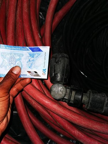

Postby nervewrecker » October 7th, 2020, 7:58 pm
Pressure washer tip, 360 degree, adjustable pressure.

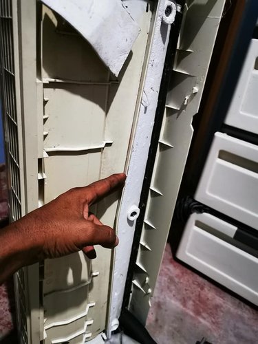

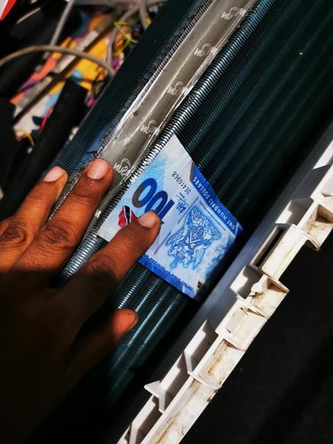

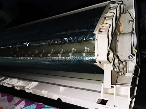

Re: What the Best Split level AC Units...Carrier LG, Panasonic?
Postby nervewrecker » October 7th, 2020, 8:00 pm
Front and back of unit, yes it does have coil in the back, some units almost 50%
See hundred dollar bill for reference of depth of coil in the back, 24000 btu daikin inverter.

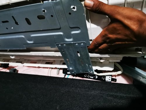

And de infamous back drain pan. Rumored to exist among technicians, the ones who know, they know....like pre 2010 ole talk.
