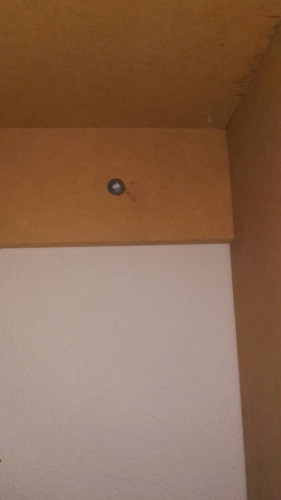

Hey guys need some advice.
If u zoom u will see a wood strip on the inside at the top, middle and bottom. It already have nails from an air gun installed. About 4 on top middle and bottom. However another guy sayin we need to put added reinforcements so the cupboard wont come off the wall when when put weight in there. What u tink?
Re: Building a house in Trinidad
Postby rspann » June 17th, 2018, 9:54 pm
Nails were used long ago, some people still believe in them, but weight can pull the cupboard off the wall sometimes. If you pull out one of the nails you will realize the cement from the mortar formed a coating on the nail, that is what bonds it tight in the wall. It is an easy fix though. Just drill some 1/4 " holes through the wood into the wall and use some hit-its (metal hit anchors),that will hold very secure.
eitech
Posts: 3629
Postby eitech » June 17th, 2018, 9:59 pm
rspann wrote:Nails were used long ago, some people still believe in them, but weight can pull the cupboard off the wall sometimes. If you pull out one of the nails you will realize the cement from the mortar formed a coating on the nail, that is what bonds it tight in the wall. It is an easy fix though. Just drill some 1/4 " holes through the wood into the wall and use some hit-its (metal hit anchors),that will hold very secure.
How many anchors for each section? Would concrete screws work as well?
Postby rspann » June 17th, 2018, 10:04 pm
The screws could work , but the anchors never come out unless you grind off the heads. I use them in every cupboard and they have never gailef yet. Also its just one hit with a hammer. Seeing that the cupboards are already in place it will be easier. If you are building from scratch, the screws might be an option.the
Postby rspann » June 17th, 2018, 10:08 pm
Two feet apart works for me.
eitech
Posts: 3629
Postby eitech » June 17th, 2018, 10:14 pm
rspann wrote:Two feet apart works for me.
Kool man. Tnx. In terms of size of the anchor, what am i asking for in the hardware? I see u mentioned drilling a 1/4” hole though...
Posts: 29388
Postby pugboy » June 17th, 2018, 10:25 pm
They are usually 1/4" thick but the come in different lengths
You need to make sure the part which expands when the nail is hit in will be in solid mortar or the brick itself ideally. So buy length to accommodate the thickness of the wood and the plastering over the brick also
Would guess about 1 3/4 or 2" long.
