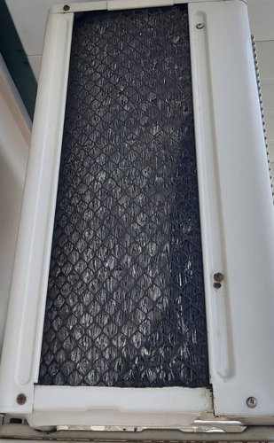

Nerve, I have a 12k installed 7.5 yrs ago, those fins on the external condenser is turning into powder when touched and looks whitey. It works though but should I be concerned?
Posts: 23834
Re: What the Best Split level AC Units...Carrier LG, Panasonic?
Postby nervewrecker » July 18th, 2020, 5:25 pm
you have a leak on the coil.
$600.00 to repair.
Up to you....

He has a refrigerant leak. Quite possible from moisture existing in the system due to purging lines and not using a vacuum. Moisture reacts with the hygroscopic oil and breaks it down forming an acidic by product. Eats away the coils from inside and the weakest point breaks.
The oil dissolves in the refrigerant in its liquid form and moves through the system hence where there is a refrigerant leak you see oil reside. The wet spot on his coil is an indication of a refrigerant leak. The oil supposed too move with the refrigerant to lubricate moving parts that may be in the system like valves etc

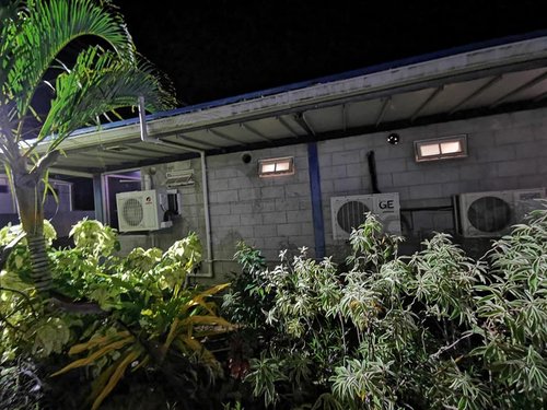

Have a look at the Gree 24000 btu we just install in dumore guard booth vs the GE 24000 btu in the room next door. I had to put in a Peak 12 to cool the room with the GE 24000 btu. I am not saying the GE is not a good unit or anyone robbing you. But if the room not big enough for a full 24000 btu explain to the customer they can get a slightly smaller unit that is rated at 24000 btu but it maybe closer to a 21000 btu which is what you might need for the room. Save some $$$ and buy the GE, heck you getting built in wifi and thats a plus (this GE is an older GE just so everyone knows).

Yea, so we handling heavy equipment tooImage
