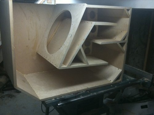

pugboy wrote:IMG_0199.JPG
Didn't you build a TAPPED Horn 18" ? I actually Built a pair of 15" Cubos a few years ago. Served me very well, but the size was almost comparable to a single 18" reflex sub. For Trinidad's style of music, I think reflex boxes are the best suited (for Pro Audio not home). Horn boxes are large and heavy, and peaky sometimes.

Postby pugboy » January 23rd, 2019, 12:51 pm
Yeah I built a one
But never got around to building a second
So have it away
