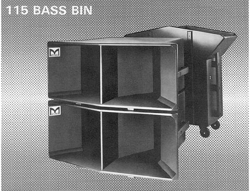

anybody have experience with the Martin Audio 115
got some 15"s around and want to try some,

They're supposed to be more applied for kick / low mid frequency reproduction. Not bass per say. If you want a good efficient and simple kick bin, you better off just building the HD15 on the speakerplans website. Smaller and easy to build.
If want bass, the best small box is the cubo15.

Kasey wrote:They're supposed to be more applied for kick / low mid frequency reproduction. Not bass per say. If you want a good efficient and simple kick bin, you better off just building the HD15 on the speakerplans website. Smaller and easy to build.
this what u talking bout Kasey ?
Kasey
Posts: 1012
Location: Earth
Re: Sound Systems Discussion, please read first post
Postby Kasey » August 9th, 2017, 9:19 am
You are correct.
