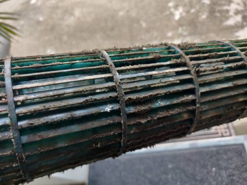

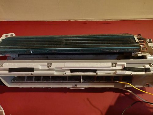

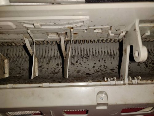

Trying my hand on a lil ting... first time cleaning out an ac, lol and to believe I installed the systems myself home here.
Vacuuming out and cleaning drain lines after.
Washing with hot water and a little dishwashing liquids and it coming back crips
6 months of buildup running 4-6 hours a day.

Try not to get the evaporator motor bearings wet.. Or else later down the road is fanbelt noise in yuh house
nick639v2
Posts: 2759
Re: What the Best Split level AC Units...Carrier LG, Panasonic?
Postby nick639v2 » September 13th, 2019, 4:20 pm
Na all bearings and ends I take out get a lil lube back before put up
