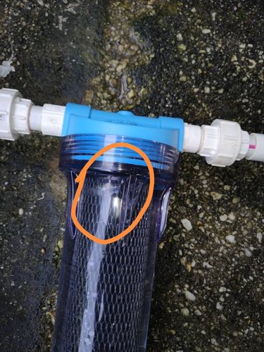

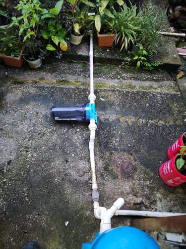

pugboy wrote:
Hey dude can I ask for some free advice? (I have some Leffe Brun if you're into that)
I decide to put a water filter before the pump because I haven't cleaned them in about 2.5 years... Will some air in it do any major harm to the pump?
that's the amount of air in the filter
that's the area, the tank at top, filter, and pump location.
(I eh power wash in some months...)
Posts: 18408
Re: Water pump
Postby Dave » July 7th, 2021, 6:00 pm
Usually filters has an air purger on top for that reason. Does yours?
I don't see that amount of air causing any sort of harm once kept to a minimum.
Water also acts as a cooling to the pump.

Postby alfa » July 7th, 2021, 6:20 pm
Won't cause harm but if air gets into the pump it will reduce it's efficient and you'll have to bleed the system. Filter supposed to have a bleeder button on top as someone said

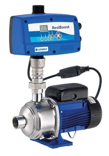

New SmartHead.

Postby viedcht » July 7th, 2021, 7:03 pm
Had to put it lying down, air purger just spurting water because of it. I had to fill it with a jug then connect it. It just have a little air pocket.
Dave wrote:Usually filters has an air purger on top for that reason. Does yours?

wheelbarrow wrote:
New SmartHead.
Saw K. Ghany Ent. advertising this
Posts: 20001
Re: Water pump
Postby Chimera » July 7th, 2021, 7:14 pm
https://www.facebook.com/thewatersource ... 6846455761
watersource has something similar for 605
It replaces the pressure tank, pressure-switch, check-valve and pressure gauge.
The Compact 2 is designed to control the operation of your water pump.
Features:
Adjustable cut in and cut out pressure
Reset Button
Replaceable circuit board
Fault Light
Small reserve against leaks in installation
Safety System - prevents pump burnout!
Automatic Reset Test function
Please note we remain CLOSED for business until further notice.
Feel free to send us a direct message for more information.

Postby viedcht » July 7th, 2021, 9:10 pm
I think I'll just flip the housing, the air bleeder on the mounting/ floor side.

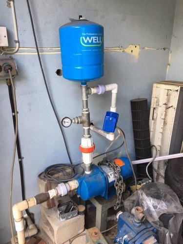

Just went through the thread... Didn't realise there was alot of info in it I never knew... By the way pugboy, I saw this photo of yours.... .
I only used to the complete setup stores usually offer. This is advanced... Does it use 1 or 2 pressure switches?
nismotrinidappa
Posts: 1065
Location: under d diff
Re: Water pump
Postby nismotrinidappa » July 8th, 2021, 10:42 pm
I like the chain for the thief lol
Posts: 29315
Re: Water pump
Postby pugboy » July 8th, 2021, 10:48 pm
Lol, my dad had put that chain on it, I only added the cycle stop valve later on.
It has normal pressure switch, just that I had it hung when testing the cycle stop valve,
Which works great for a high usage install.
IMG_20210707_170618.jpeg that's the amount of air in the filter
IMG_20210707_165912.jpeg that's the area, the tank at top, filter, and pump location.
As someone that manages 92 water pumps ranging from 1/2HP to 10HP please dont put a filter on the suction side of your water pump. It will restrict flow and cause your pump to cavitate reducing its lifespan tremendously.
viedcht
Posts: 2049
Re: Water pump
Postby viedcht » July 10th, 2021, 8:27 am
^Yeah I done pull it out arredy. Same evening it start causing problems. Organised with some help to drain and clean the tanks... Costing a grand in total, because I have 2 600gal on one side connected to each other, 3 450gal on other side of platform, and a reserve 450gal. Going to do some plumbing alterations and getting the area power washed for that fee.
To anybody who does neglect their household water system like mihself... Doh do like me; clean Yuh tanks dem often, even if you filtering your kitchen and shower plumbing. Filter wasa line instead.
