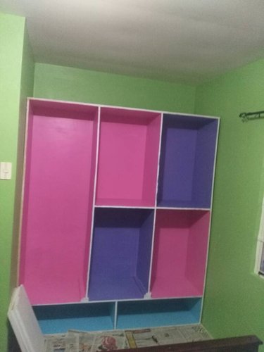

Postby jl6106 » October 23rd, 2019, 6:14 pm
Just an update. Treated, primed, sanded , primed.
Plan to do some fun colors for the girls and the drawers last.

Postby speedmelter » October 23rd, 2019, 9:19 pm
Looks very nice man!!

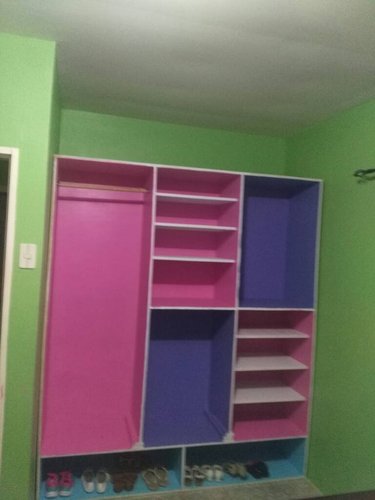

Postby jl6106 » October 24th, 2019, 6:41 pm
So this is how far I've reached. Will try to build one drawer a day until I'm finished ( only one clamp). Afterwards, will focus on face frame and doors.

Postby pugboy » October 24th, 2019, 7:25 pm
Very nice and looking all square
Re: Carpentry, Joinery and woodworking Forum
Postby Rovin » October 25th, 2019, 10:55 am
nice colors
how u intend to attach d face frame to d body though ? ...

Postby jl6106 » October 25th, 2019, 11:07 am
I thinking glue and some small nails. If I could get a countersink bit, I'll use screws and fill over.

Postby Rovin » October 25th, 2019, 11:14 am
that cud work
if u have a 18g nail gun dat wud be nice
if u using screws use some narrow gauge screws & still pre-drill to lessen d chances of splitting ...

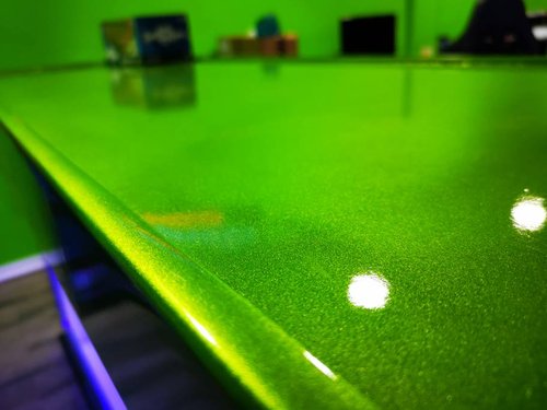

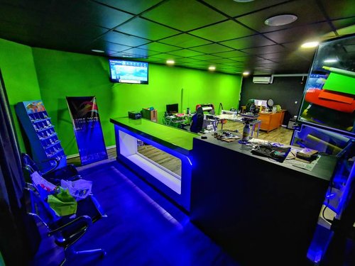

Postby gastly369 » October 25th, 2019, 12:25 pm
Front counter in the making

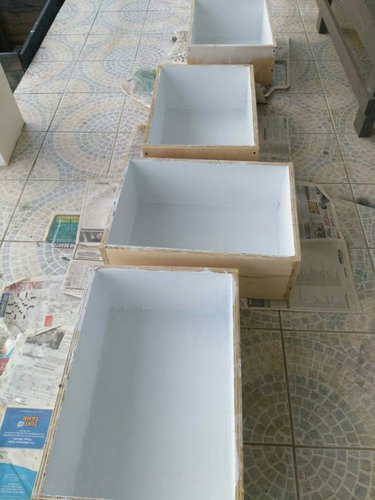

Postby jl6106 » October 28th, 2019, 1:22 pm
Completed the drawers with screws and glue. Then I had my daughters seal the inside corners with hot glue. Then primed the inside for paint. Planning to install sometime this week please God.

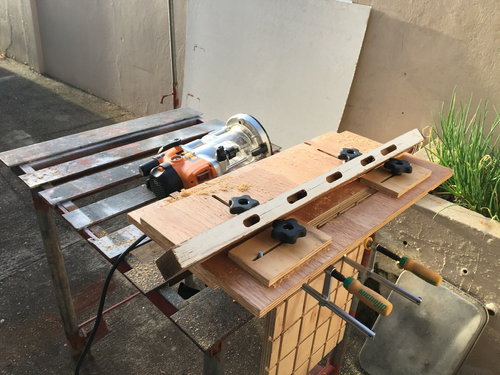

Postby pugboy » November 7th, 2019, 6:59 am
Works
Need to calibrate the stops and center marks
Postby Rovin » November 7th, 2019, 10:51 am
dise d big triton router u rockin dey ?
honestly if i were doing woodworking for a living or really dont mind spending d $$ i wud buy d festool domino , from what i seeing on youtube by far it is d fastest most efficient way to make mortises
all dem jigs ppl making all over youtube will work i eh say no but i find they all looking too fiddly & cumbersome to use ... :|

Postby pugboy » November 7th, 2019, 9:18 pm
Yeah tra001, have it a while now
Bought it on sale.
Domino nice but way too pricey.
They say the patent running out soon so might some Chinese versions.
So far it seems this jig is a winner, just need to calibrate and make proper markings for centering.
