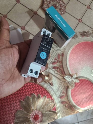

Installed two of the tongou TO-Q-SY1-JWT relays today and they work well with the app.
One turns on the contactor for the water heater for 15 mins in the morning and 10 mins in the evening to save electricity.
The other controls power to the motion sensor for the spot lights. It becomes active 6pm and inactive 6am.
These are in the testing phases.

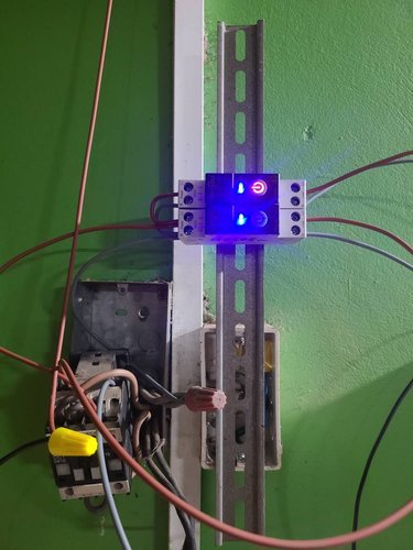

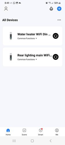

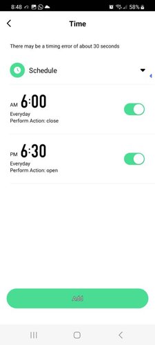

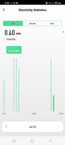

Nifty little device, Ignore the hack wiring, I already have panel boxes etc.
Yes I have a contactor controlling the water heater. You can set schedules and the current consumption log shows when the device is active through the spikes in current usage. So you can reference it to your cams.
I like the fact that I can control things from anywhere. A ups would keep wifi online and an atf (there are din rail mounted units) can separate cams, sensors, relay bank and lighting from the grid in case they cut the power.
Right now switched lights are on the same circuit with sensors but the sensor out feeds the light switch out contact or direct to the light (same phase of you running a separate line so its not a short circuit of someone turns on the switch). I have yet to put these on relays so you can switch on individual lights at will or have them come on at random times besides the motion sensor activation.

very nice logging info, gonna order a couple to play with.
only catch is they are cloud based, when internet down etc it is unpredictable what happens.
where did you mount the rail ?
inside a box or something ?

Postby nervewrecker » July 22nd, 2024, 9:25 pm
Yes, I got some pvc boxes from Modern Electrical. I think they are 9x9 so they can fit an entire bank and it has room to wire neatly.
There are dedicated din rail enclosures from Amazon as I can't find those here but my concern was room to swing wires.
There are also din rail mounted contactors on Amazon from the same geya line that are about $12usd that can fit nicely and can separate flood lights from domestic with a 220v supply to them but be triggered by the same circuit as the domestic lights. Flood lights run cooler at 220v so they should last longer. I honestly won't put more than 10A on them for longevity. Took a chance with the tongou relays as we have a lot of merchandise on the market in use like small cams. The geya smart switch is almost 3 times the price.
Contactors can control a solenoid to move a door latch back and forth to lock or unlock burglar proofing. I haven't done much research on the brushless motors and how best I can control them to open and close doors as yet.
