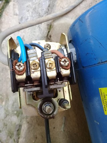

sounding like pressure switch malfunction,
buy the square D brand

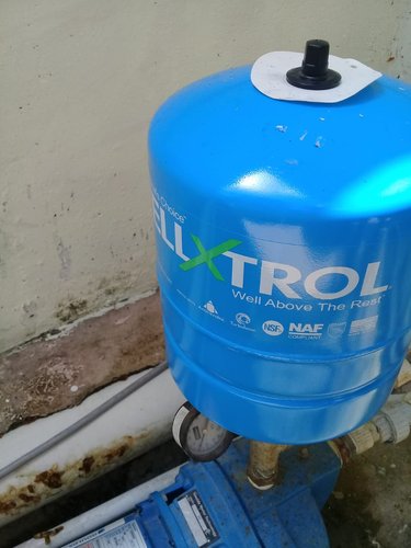

buy a good quality brand pressure tank, like wellxtrol
Goulds motors are much beefier than the competition, if you just look at the motor windings it is chalk and cheese.

pugboy wrote:buy a good quality brand pressure tank, like wellxtrol
Had the wellxtrol...
Take a look at switch...change it?

Yeah and make sure check valves good

If the pump will not function while the pressure terminals are touching (as shown in photo) the pump or wiring is malfunctioning.
Verify that that pump works by checking the electrical supply wires with a test light. Then wire the pump directly to the supply to see if it works.
You can try to clean the contacts with an electronics cleaner but the contacts look clean.

Changed the tank, checked valves...works like new...still wondering if I got a bad tank when I purchased it a few mths ago

Well it’s rubber inside so maybe you got a bad one

i have one a little over a year now, previous one lasted 3 months, one before that lasted 2 years.
rell hit and miss with these things, expensive nor mc.

The pressure tank we have at home is a big fiberglass one and the rubber seem to be lasting real long, must be over 15yrs
but similar sized metal one at another location didnt last 5 years.
I replaced it with the smallest sized one available and put the cycle stop valve which works like a mechanical smarthead
cheaper in the long run and the cycle stop valve throttles the pump output to 50psi and only when water demand ceases does it slowly run up to the 60psi and pressure switch cuts off, so less hard jamming on the pressure tank.

I heard people saying its better to use a bigger tank than what was originally sent with the pump...any truth to this?

Yes, the tank acts as a buffer for the demands
So pump will cycle on and off less

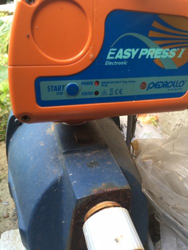

Bumping this thread for some help. My pump is only cutting off and not coming back on. It has a smart head and the status button is blinking instead of remaking on. If I manually hold down the power button, it comes on and builds pressure. Water will flow but once i turn off the tap and it cuts off, if I turn back on the tap, the pump will not come back on. See pics for clarity. Really trying to sort this out urgently. Only started happening yesterday.
khandman
Posts: 243
Joined: November 22nd, 2007, 12:27 am

Postby pugboy » March 28th, 2020, 8:37 am
unscrew that smarthead and throw it in the sea
also go to a rotoplastics store and hang around a while
you will surely see a few ppl coming to buy one.....
a small pressure tank and pressure switch will be cheaper to buy too

Time for a new Smarthead.

why does a device need an “easy press reset”?
does it need to manually reset often?
if you had to stop and restart your car whilst driving would that be ok?

This a replacement smart head that I bought about a year ago

pugboy wrote:why does a device need an “easy press reset”?
No it doesn’t need to reset at all usually. So as this started happening I know that something is very wrong

get a plumber to remove and install a pressure switch and pressure tank
