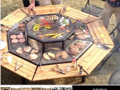

what type of steel/metal should i use when making grating for a bbq grill?
normal 1/2 inch smooth steel is good?

Phone Surgeon wrote:what type of steel/metal should i use when making grating for a bbq grill?
Ideally some sort of stainless
Mild steel will melt up with heat and caked on food
not the welding rods......the stainless steel itself i mean
or what can i use if i making this?
normal solid square or round steel?

You can also use flat expanded steel. Either carbon or stainless will work well.

is using non stainless you need to use often to avoid rust,
if left with crud on, the crud corrodes if not used often.

better i just buy a sheet of expanded steel then ent
corrosion wise...is there a specific paint i can use to protect it?

no paint if you cooking on it
thats why you need to use often
Phone Surgeon wrote:better i just buy a sheet of expanded steel then ent

yeahh but how often is often.....
if i pressure wash it and keep it clean between uses it shouldnt corrode?

yeah, and spray some cooking oil on it after
its the burnt bits which are turn corrosive
Phone Surgeon wrote:yeahh but how often is often.....

pugboy wrote:yeah, and spray some cooking oil on it after
For carbon steels, clean the grates with a wire brush, then soap and water. After it dries, apply food-grade mineral oil (paraffin oil) with a rag or a paint brush. Mineral oil won't become gummy over time the way that vegetable oil will.
Food-grade mineral oil is available at most pharmacies as a laxative.
The stainless steel grates should be treated the same way but expanded stainless steel doesn't corrode in a few days the way that carbon steel does.
