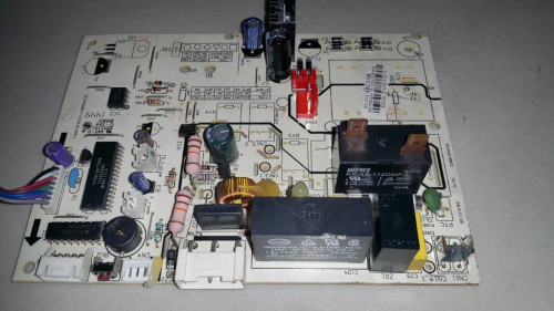

Postby supercharged turbo » June 5th, 2018, 12:17 pm
So I took out the circuit board to get the relay changed.Can anyone confirm its the black box with the 2 prongs?Just want to make sure before I buy it.

supercharged turbo wrote:So I took out the circuit board to get the relay changed.Can anyone confirm its the black box with the 2 prongs?Just want to make sure before I buy it.
Yes, black box with the two prongs.
Check for continuity across them first to see if they stuck closed.

Can get the relay by peake to buy $100 you can change it yourself if you have access to a soldering iron
