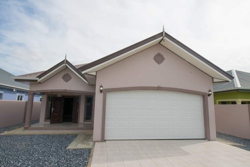

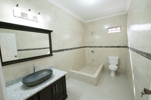

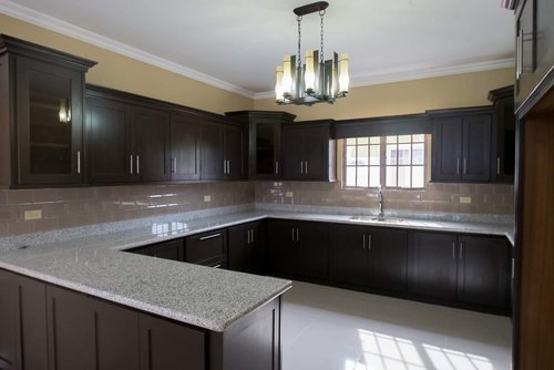

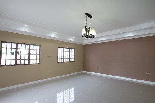

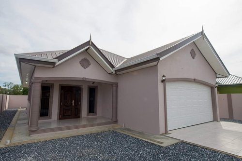

Just saw this pop up on a fb ad. It cost 1.6m land is 5200sf, house is 2200sf. How much would it cost (in 2019) to build such a house, given that you have your own land.?
Re: Building a house in Trinidad
Postby rspann » May 31st, 2019, 1:55 pm
eurotuner wrote:Just saw this pop up on a fb ad. It cost 1.6m land is 5200sf, house is 2200sf. How much would it cost (in 2019) to build such a house, given that you have your own land.? FB_IMG_1559321538716.jpegFB_IMG_1559321517486.jpegFB_IMG_1559321521607.jpegFB_IMG_1559321519544.jpegFB_IMG_1559321523682.jpeg
When you buy 10 acres for $350g and building like a factory with the same crew just pumping out one after the other ,you could sell that for $1.6m and make profit. If you go to do that yourself it might cost you more.
carluva
Posts: 1993
Postby carluva » May 31st, 2019, 2:38 pm
spann, are you serious? With land, that house would cost as much as 1.6m to build as shown in the pictures? Waw!
Postby adnj » May 31st, 2019, 5:14 pm
carluva wrote:Just a comment.
There were quite a few of those houses in cunupia and environs that I checked out a few years ago for my parents.
For those houses, I found that things were not exactly as advertised.
For example, the teak kitchens were really teak MDF, not teak wood. Same for the bedrooms.
AC units were cheap units.
The decadent tiles were cheap ceramic tiles.
The Garage opener and gate were cheap Chinese brands. Same for faucets.
All in all, I found that the houses were cheaply finished and I won't be surprised that construction was done similarly, like using smooth steel instead of the corrugated steel.
I think an uninformed buyer would think that the houses were good for the price but for someone who as at least built their own house, you would be able to spot the cheapness..
Builders would minge on cost everywhere and sell at market value to maximise profits. IMO
This is the same house for sale that was discussed here from Dec 17. There may be a pricing problem.
Posts: 29402
Postby pugboy » May 31st, 2019, 5:49 pm
them fellas have links to convert the cheap agri land into residential and backfill all how
plus they does do all kinda thing to "improve" any drainage deficiencies
carluva wrote:spann, are you serious? With land, that house would cost as much as 1.6m to build as shown in the pictures? Waw!
Posts: 20061
Postby Chimera » May 31st, 2019, 6:12 pm
Land in that area is 300k per lot.
They do buy blocks of 5 acres and 10 acres and develop it. And same crew working nonstop for the last 5 years.
