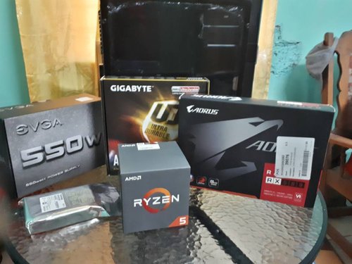

urbandilema
Posts: 1030
Postby urbandilema » November 18th, 2018, 9:09 am
Ryzen 1600 6 c 12 t...runs nice with 16 gb of ddr4 ram..it came up around 1300 tt with taxes and shipping..
kamakazi
Posts: 2931
Postby kamakazi » November 18th, 2018, 1:50 pm
I'm trying my best to hold out until Zen 2... But if a good deal pops up I might go for it. I require single thread performance more than multithread, and the original 1600 matches my current CPU (i3 6100) in single threaded benchmarks
urbandilema
Posts: 1030
Postby urbandilema » November 18th, 2018, 5:29 pm
Yeah it's good but for video editing u cud for intel..did sum light editing for a school project in the programme I'm persueing.thats the reason for my build..wanted at first a i3 then end up with this build...gaming on it is great for fornite max setting ..the new forza it's excellent..great build and I'm satisfied for a while

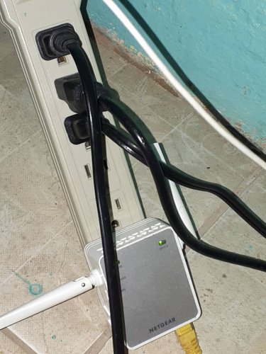

Postby Ted_v2 » November 19th, 2018, 5:46 pm
Need some advice, have a flow modem with a built in router. Works upstairs in my house perfectly, built a shed at the front , with all my windows and doors burglar proof ect. The internet connection isnt what it was long time.
what could be done to get internet downstairs, need like a 25ft booster. All connections are wireless
was looking at something that plugs into your wall outlet and sends the signal thru ur 110v plug at a diff freq.
or a signal booster
what you all recommend.
skylinechild
Posts: 5692
Location: In a Skyline
Postby skylinechild » November 19th, 2018, 6:40 pm
Ted_v2 wrote:Need some advice, have a flow modem with a built in router. Works upstairs in my house perfectly, built a shed at the front , with all my windows and doors burglar proof ect. The internet connection isnt what it was long time.
or a signal booster
you could try relocating your flow router - to a more centrally located area where u want the wifi - which is free
you can purchase a range extender - also called a repeater - about #350 or so....
you can do away with the flow router and buy your own high end unit and hook it up and just use the flow router as ur gateway.
if you have a old linksys router you can turn it into a repeater - indtead of buying one
heres how >>> https://lifehacker.com/how-to-extend-yo ... -915783308
urbandilema
Posts: 1030
Postby urbandilema » November 19th, 2018, 9:38 pm
I have one of those extender works will...
urbandilema
Posts: 1030
Postby urbandilema » November 19th, 2018, 9:40 pm
urbandilema wrote:I have one of those extender works will...
This is mines here...
