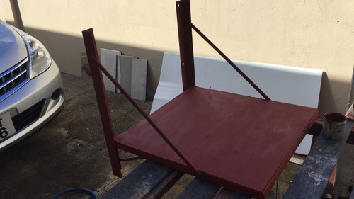

Friend asked me to build a bracket to hang a 20gal tank water heater off wall with anchor bolts
The wall is made with regular clay bricks. I am a bit skeptical they can take the weight and pressure from the bolts.
What you guys think ?

pugboy wrote:Friend asked me to build a bracket to hang a 20gal tank water heater off wall with anchor bolts
Usually you can make a couple plates and go through the wall with Long bolts. If not, then you can measure and find the point where the 2 blocks meet horizontally and the anchor bolts will work fine there.
Re: Building a house in Trinidad
Postby adnj » September 1st, 2018, 9:30 pm
A 20 gal water heater weighs about 240 lbs.
If the wall is plastered (>=1/2"), and you use the proper size and number of sleeve anchors, you can reasonably do it.
The wall brackets should be firmly attached together to prevent single support failure.
If there is no plaster, do what matix suggested. I would use six fasteners minimum on a bracket that is more than 16 inches high to span three block seams. I would bolt through a vertical strap on the opposite side of the wall; one for each bracket.

The bracket has 3 holes per side, I planned to use the same 3/8 sleeve anchors,
however my concern was anchor strength in red brick.
the property has a similar bracket in another apt but in a concrete brick wall.
I dont consider it a good practice either.
I think I may add a vertical post to the ground strapped against the wall to remove some of the load on the wall anchors.

No need for a vertical post. Put two similar diagonal braces like the two you have above ,at the bottom. They will take away some of the horizontal outward force from the bolts and put it towards the wall at the bottom.
Easier thing would have been a bolt through the wall with a piece of flat acting as a washer inside.

The bracket looks solid. Your idea to add a floor support would certainly help.
Edit: I believe that the problem is not the shear strength (downward force) of the bracket and fasteners. The problem is the pull-out resistance of the clay block itself. The static load is only 50 pounds max.
If the clay block attachment fails, it will most likely just pop out completely. I would go through the wall.
