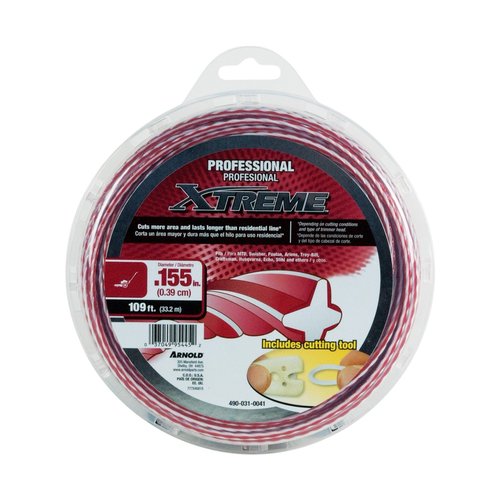

Is to find the square ones boy.. pressure.. i using a red and white twisted one from bhagwansinghs since i can't get the white square anywhere.
It does the job and minimal bursting
