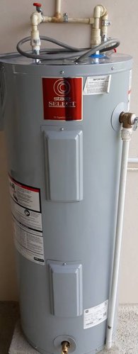

This is our 30gal install. What you guys think? Any comments or recommendations, if any?

Is that a checkvalve next to the union on the cold water inlet line?
That checkvalve is essential.
Also pipe out the T&P away from the heater, the body of that heater will rust is water comes into contact with it.

Wheelbarrow, thanks for the tip bro. We will make the necessary adjustments!

heat should be put off the ground just in case of any water on ground etc
as mentioned to avoid any rusting of the body.

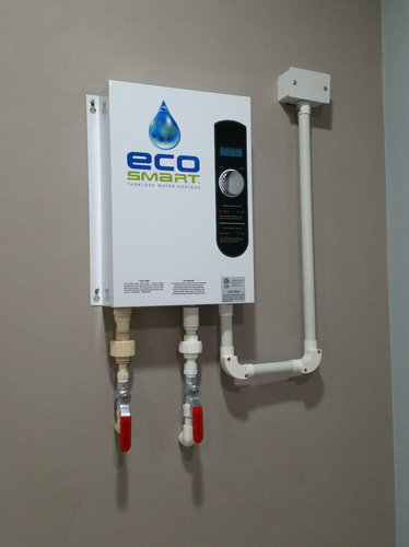

Imported and installed an Eco Smart 18 tankless myself a couple months ago. It delivers to 3 showers, 3 face sinks , washer and kitchen sink. works great so far
runs on 2 x 40amp d/p breakers
cost around $2600 landed as i got it on sale . reg price locally is $6195 but with 5 yrs warranty at samlal seepersad hardware in marabella

agent007 wrote:This is our 30gal install. What you guys think? Any comments or recommendations, if any?20180205_065937.jpg
Bought this same exact unit carnival weekend. Cost me $2690 ( sale price)
The old Reliance single element 30 gal. unit I had to replace lasted 18 years of daily use with one replacement of the element 2 years ago !! Can't complain about that. Wanted another Reliance to replace but couldn't find one over the Carnival weekend so bought the State Select instead.
