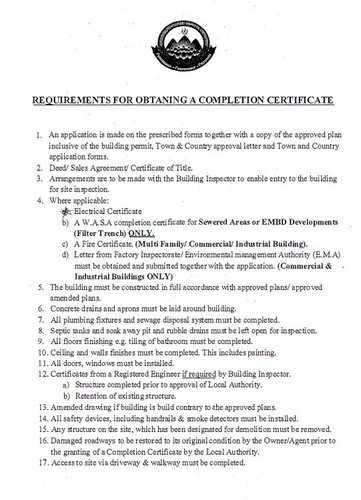

SmokeyGTi wrote:Hey guys,
Don't know if this is a repost, but to anyone interested in obtaining approvals from a Borough or regional corporation, the following link will prove useful:
http://www.tunapunapiarcoregional.org/bi.html
CTTRC Completion Certificate Requirements that I got yesterday.
