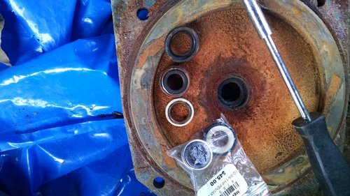

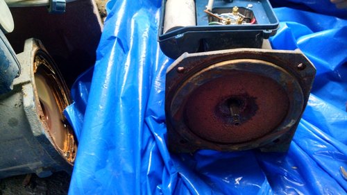

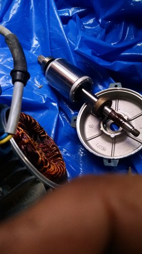

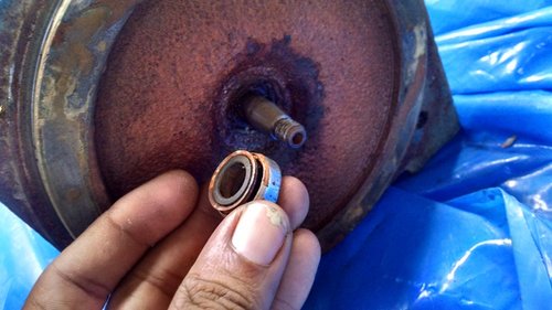

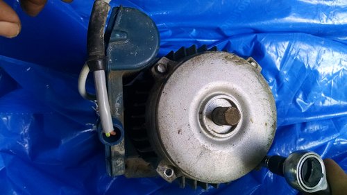

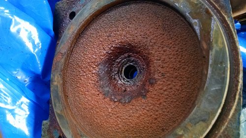

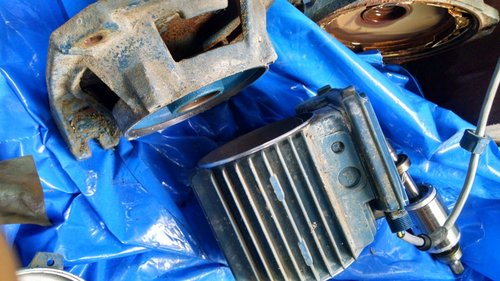

On another note, las week i noticed around my pump was extremely wet, on closer inspection i realized everytime the pump came on water was flying out by the shaft. Thanks to pugboy and wheelbarrow i got the answer. Shaft seal!!!!!. I had a pentax pump before for 15 yrs and never changed this. This new pump maybe just clocked a yr and this crap came up.
Heres the work around.
Unplug pump, unbolt 4 bolts holding pump halves together, using a screw driver i slowly separated the two halves( be careful as there is a rubber seal, now you guys know what inside you one yr old pump looks like.rust)
Tap out the fan cover, take you time and pull out the fan.Used a big wrench to hold the shaft on fan side and a 17 socket to break the impeller nut off the shaft(counterclockwise to loosen)
Once the pump was separated it took me a while but i was able to pry the old shaft seal out. had to use some lubricant on the shaft itself.Using a flat head screw driver, i pried piece by piece around the seal while turning the shaft.
After getting that out i realised something was missing, i had extra parts with the new shaft seal. Turn pump motor around and take out 4 10mm screws and tap the back out.
Then tap the shaft from the impeller side out.( i used a piece of wood ontop the shaft threads and tapped that as to not damage the threads.
Thats out,and still didnt know how the ass i getting the seals. turn to front half and gently tap the front cover off too.
Thought that was it,wrong, there is a hard white plastic and another rubber seal there( hard to see, didnt want to chance it as i was already in the pump, changed all one time)
once you get front cover off, i tapped out white hard plastic, pulled out rubber reinstalled the new ones, put back everything including the shaft and then slide new shaft seal on.(used some grease on mine to slide it in easy)
All parts installed, reversed process and re-assembled everything, put grease on 14mm nuts as to make it easy to remove in future and stop rust from elements
PLZ NB...
1. I was given a shaft seal that was wrong and had to go back. I suggest taking this off first or asking for the correct one. This specific pump is a cam 75 and uses a 1/2-3/4 shaft seal
2. I am not responsible if you try this and firetruck up your pump. do at your own risk as you have to have some patience and have some technical mechanical experience.

Posts: 29373
Re: Which residential water pump to buy?
Postby pugboy » December 8th, 2015, 5:48 am
Nice, you are a pump service expert now :)
Note, be careful with the white mating parts of the shaft seal, they are precisely flat to mesh together
and spin but not let water pass, so any dirt getting between will abrade the surface.
Maybe when yours was assembled at factory some dirt got inbetween and eventually caused it to leak.
