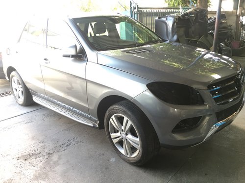

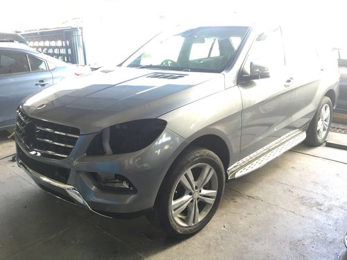

Lol at heating to release spot welds though. Skyline, if you see me line up a car ,you might just be amazed,and that is no boast.
Wah is ur garage? Lookin for a new body works place because the last one i deal with fail all how and loss a cash payin customer tryin smart ting. And i hope u as good as u toutin to be eh.
I don't have to tout pappi, my work speaks for itself. This is how I do it, three days.
