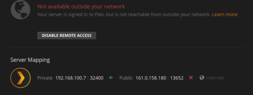

Hey guys, any of you got Digicel fibre and got the PLEX server to work remotely?

Postby uberchic » January 21st, 2016, 8:38 pm
firewall - i'm not sure
the server access isn't available outside the network

Check and make sure that public ip shown in plex matches that of your isp. What OS are you running plex on? Do you have IPV6 enabled in your router? If you do then you need to enable it in plex.

Yup ip matches. IPv6 is enabled in plex.
Currently running it on a Mac mini with El Capitan

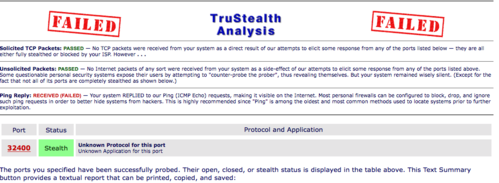

uberchic wrote:firewall - i'm not sure
go here https://www.grc.com/x/ne.dll?bh0bkyd2, click proceed.
type in 32400, click user specified custom port probe. What's the result?

Here are the results.

I had this problem in my plex setup before and was due to jumbo frames and ipv6.
Check this https://support.plex.tv/hc/en-us/articles/200931138-Troubleshooting-myPlex-Server-connections for some insight on troubleshooting no remote access.

Yeah digi fiber has a firewall on the modem that cannot be turned off at present as it requires a firmware upgrade.

Postby wagonrunner » January 22nd, 2016, 12:08 pm
whats the make / model of the "digicel" device?

Postby uberchic » January 22nd, 2016, 3:22 pm
Huawei Echolife HG 8245Q
