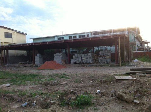

Steel quicker and in my opinion cheaper in the long run. I did three like this with one set of 2x4's and plywood to cast the deck.

rspann wrote:Steel quicker and in my opinion cheaper in the long run. I did three like this with one set of 2x4's and plywood to cast the deck.
What's the dimensions of this structure and the cost up to casting floor (foundation, steel structure, ground and 1st floor)? How does the cost compare to concrete?

York, most realtors or speculators add in for their profits ,so subtracting the cost of the land from the total does not include profit. Most people go by what they see properties advertised for and think they can get the same for theirs. Most properties nowadays are greatly inflated since we have an artificial real estate economy driven by laundering, speculation etc. Generally if I spend $1m on a building it is valued up to $3m immediately upon completion.If the land is $6-700,000, you can see the mark up I'm speaking about.
In response to your question, The structure I posted is 35ftx 80ft. Foundation material(ground) is approx $50g ,beams was around $75g and the two floor slabs cost $60g.Labour is around $60g including fabrication. Blocking up and plastering is relatively cheap ,but the finishing is where the money goes. In my case they are apartments so it's forty doors, eight toilets, eight kitchens ,you get the drift.
Can coke, I doing a 35x 60 house right now ,load bearing 6" walls downstairs and h/c blocks upstairs ,pm me and I'll show you how to get it done at a very reasonable cost. Abut half the cost if you use a contractor and none of the headache.
