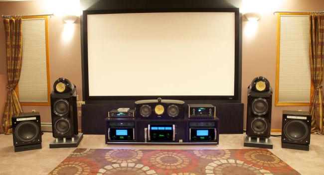

The large port u see there is for the sub...it's huge but I'm using a fair length to tune the cabinet to 26hz.
I'm contemplating doing a down firing sub and letting the port vent to the front.
Similar to this:
However. I was also considering doing the typical sub in front and port firing out to the back..
My other option is also 2 10" subs (more cone area) that can handle low frequency with good efficiency ( gotta be the right sensitivity)
With 2 10" subs my new port frequency will be 27hz which is OK for what I want to do.
The power for the sub will be a BASH Class D 325rms @4ohms.

Re: *** THE OFFICIAL HOME THEATER & AUDIO THREAD**
Postby X_Factor » July 1st, 2015, 7:43 am
if ur going with two subs, most ppl build two seperate boxes and put them on the sides of the towers rather than one enclosure for both which may pull the soundstage to one side
Chiney
Posts: 4675
Location: Maracas,St.Joseph
Postby Chiney » July 1st, 2015, 8:04 am
Nope. Subs are supposed to be tuned transparent. Subs aren't supposed to "have a location" also., staging in HT is done with because of the rears and rear surrounds. What is considered is imaging. Because you are supposed to hear someone sneaking up behind you and make u look back lol.. I don't agree with your statement sorry.
