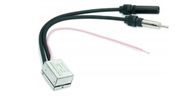

Looks like this for most models, some nissan models have a slight variation.
Installation is pretty simple, just need access to rear of deck/unit and "hot" positive, usually tapping into cigarette lighter lead is a good option.
We actually install these on all units/vehicles we deliver, while doing first engine service etc, unless we upgrade or replace the deck/unit for the customer.

ALIS wrote:Looks like this for most models, some nissan models have a slight variation.
theres different versions of the converters some come in a 14 MHZ frequency shift and some come in 18 MHZ frequency shift.
for example using the 18MHZ frequency shift unit 95.1fm becomes 77.1MHZ - just minus the frequency shift and you'll get the station frequency to tune into.
besure you purchase the 18MHZ unit as the 14 MHZ unit will not give those higher stations beyond 103fm
