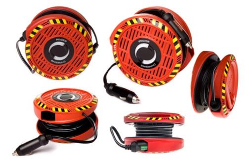

Have any of you guys used this before ? Do you think it worked well ?
Connected directly to the cigarette lighter charger, the car jump starter is a simple and safe operation that charges dead batteries quicker than Frankenstein’s creation coming to life. Compact and portable, the device is a drivers dream in road related nightmares.
Jump-start a car without opening the bonnet
Connect two vehicles between the cigarette lighter charger
Charges quickly
Simple and safe operation
Plug and charge simplicity
Green and red LED indicators display battery status
Convenient cable storage mechanism
Fits in car boot or glove compartment
Connect two vehicles between the 12V sockets

It's crap

:lol: I watchin this thing with my eyes open big and wondering how the hellllll this thing could work properly.
The pricemart jumpstart kits are much bigger than this and I have been through about 4. Until I got wise and got a Schumacher.
For diesel engines that I usually work with this thing aint have a prayer in the world :lol:

with most cig. lighters being fused about 20amps max i really dont see this working properly

This was developed for non brain box.obc vehicles like old skool v8s, 4 cylinder carbs etc..do not use this on any ecu controlled vehicle

KiD wrote:with most cig. lighters being fused about 20amps max i really dont see this working properly
It does take a flockload of current to start a car eh. Yuh doh want that current passing thru flimsy wire (cig lighters wasnt intended for high current devices), if you lucky the fuse will blow before the wire burn.
most I've seen is 10A and few 15A
streetbeastINC. wrote:This was developed for non brain box.obc vehicles like old skool v8s, 4 cylinder carbs etc..do not use this on any ecu controlled vehicle
EFI has nothing to do with a dead battery.
Majority of the current draw during a the crank goes to the starter.. EFI or Carb
Fuel and spark won't do nothing without compression.
Posts: 29315
Re: Emergency Car Cigarette Lighter Jump Starter
Postby pugboy » January 23rd, 2014, 8:21 pm
they use magic wires at the back of the cigarette lighters
thin but can carry 120amps etc

Is it really worth it to be carrying around an extra spare battery for the rare instance you may need a jump start? Unless you take care to top up the spare battery charge regularly, it's going to deteriorate and lose its ability to recharge. What are the chances you're going to remember to keep topping up? After one or two years of negligence, or a few more years with proper maintenance, you'll have to buy another one. That sounds like wasting money to me. Suppose that spare battery died due to negligence, you wouldn't know until you need it and it fails.
Jumper cables are maintenance free, lasts a lifetime, and very reliable. Unless you driving off in remote country by yourself, someone will always be around to lend assistance with a jump start. I have jumper cables from PriceSmart. They very long so they can reach someone parked behind you, they very thick to handle good current, and have sturdy locking clamps. I maintain my car battery and make sure the water level is good. I never needed jump start assistance from anyone, but helped out friends and strangers already. There were times I needed a jump start in the morning when starting from home. For that, I used a 13.8 V power supply, attached it to the car battery and left it about 10 minutes to charge. There was once I used a regular wall mount adaptor on the 12 V setting (before I had the 13.8 V supply), but left that charging longer. Was able to start up normally.
I say go with jumper cables in your car and keep a cheap small battery charger powered by AC power at home for when the battery dies overnight at home. Make sure to get top quality jumper cables with very thick wire and good clamps. Don't cheap out on them.

2nd. I doubt all that juice can leave the lighter circuit anyway.

pseudorandom wrote:Is it really worth it to be carrying around an extra spare battery for the rare instance you may need a jump start? Unless you take care to top up the spare battery charge regularly, it's going to deteriorate and lose its ability to recharge. What are the chances you're going to remember to keep topping up? After one or two years of negligence, or a few more years with proper maintenance, you'll have to buy another one. That sounds like wasting money to me. Suppose that spare battery died due to negligence, you wouldn't know until you need it and it fails.
Good Advice. Just cant see pricesmart selling good gauge wire for jumper cables. Don't be fooled by the insulation. The norm is to use a thick insulation to give the impression that the wire itself is thick. Look where it joins the clamp for the real picture.
I myself bought zero gauge wire from farfan and got heavy duty clamps from my partner Jerry (St Augustine) and soldered them together. Use these on heavy duty diesel equipment. The clamps are great also just btw. The outside is coated so even if they touch while connecting no issue at all. No electrical spark. The metal surface is only inside the clamp.
My 2c
