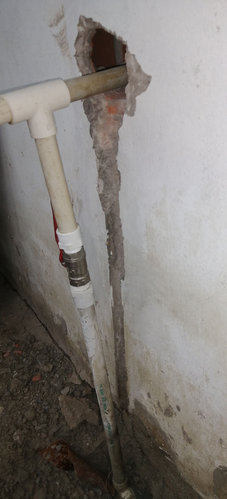

Guys,
I want to fill in the pipe indentation and repair the hole in the wall. I plan to fill the hole with pieces of red brick.
What is the best option for this? I don't really want to buy an entire bag of cement as it would be too much for my needs.
I am looking at the Plastafilla as it comes in small bags. I also saw something called Plastamix, but it's kind of a big bag. Thanks.

You can buy plastamix loose and given what it is...you can stretch with some red sand in the mix. I did the same for the same pvc holes when I had to run some pipe and had gaps to fill.

sotf
Posts: 140
Joined: May 18th, 2008, 9:15 pm
Re: Building a house in Trinidad
Postby sotf » April 14th, 2024, 3:24 pm
I chose the Plastamix.
Posts: 29402
Postby pugboy » April 14th, 2024, 3:27 pm
you should put clamps
somebody gonna bounce that and break the pvc
