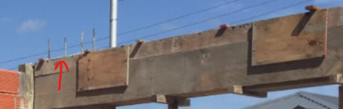

A newbie question but would appreciate some guidance. A general contractor who inspected my home constructed 6 years ago by another contractor, informed me that there are no roof tie-ins between the garage front pillars and roof. What exactly would this look like. Is it the highlighted?

Your arrows point to the exposed reinforcing bar of the two columns. So, yes. You highlighted it.
Local code requires that the rafters be fixed to the ring beam (also called a roof beam in some countries).
The jack rafter supports (on the corners) look as if they were either cast in with the beam or were bolted to the beam. They also appear to be outside of the RC cage. Because of the roof configuration (about 25 ft wide, half-pyramid hip) wind resistance should not be a problem.
If you want to be extra safe, place a U-shaped piece of rebar over the jack rafters and weld them to the exposed column rebar to prevent possible lift in case of a hurricane.
[quote][img]https://i.imgur.com/gSMa3uW.png[/img]
The rafters shall be securely fixed to the ring beam at the top of the walls on a wall plate and to the ridge board at the crown of the roof.[/quote]

Thank you very much for your detailed response.
