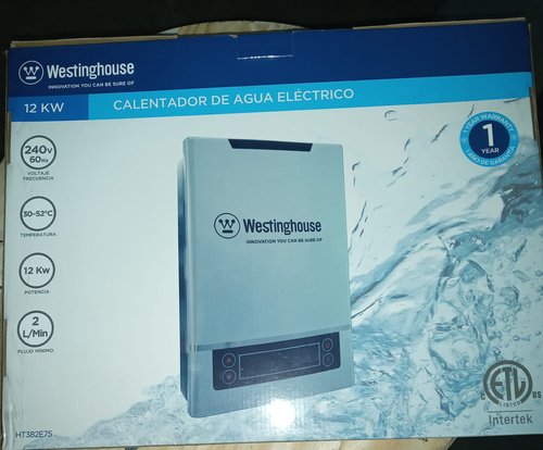

Postby Dizzy28 » October 10th, 2023, 10:07 am
Anyone has experiences with this ?
triniterribletim
Posts: 481
Re: WTK Tank or Tankless Water Heater

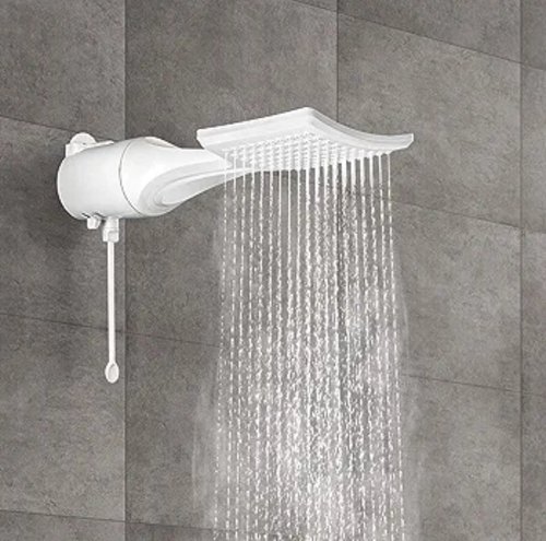

Postby triniterribletim » October 11th, 2023, 4:11 am
I'm surprised that these heated showers haven't caught on in Trinidad. Are they illegal in Trini? Almost every house or hotel in Brazil that I've ever been in has used this type of shower. It definitely gives you a good hot shower, and if you crank it all the way up, it's almost scalding hot. They go for around 101 BRL (134TTD). Plus they have them in both 127v and 220v. Everything is self contained in the shower head itself.
matix
Posts: 2362
Postby matix » October 11th, 2023, 5:29 am
Dizzy28 wrote:Anyone has experiences with this ?
Yes and I won’t recommend. Check Water Source if you want to go tankless and look for one with a higher flow rate.
Premchand1976
Posts: 1278
Postby Premchand1976 » October 11th, 2023, 5:37 am
Was told the same ( check water source ) when my 7 year old ecosmart unit had the same issue of hot then cold water. Turns out allodt No one including the dealer when i bought unit ( back in 2016 ) doesn't stock.parts. luckily they had some last parts lying around and I got the replacement part for $300, changed it myself and ting wukkin like normal.
Was able to locate ALL replacement parts online for future issues. 7 years service, 1 part changed during period, not a bad investment . Looking forward to another u years....lol
Was told by plumbers that the Westinghouse units have readily available parts locally and that the most frequently changed part is a plastic unit and not a metal one to corrode with our " residue and sediment free " water supply.
I would buy ecosmart again whenever I have to change my unit.

Postby pugboy » October 11th, 2023, 6:38 am
what you mean ?
we have the fame type for donkey years, just different looking.
have a few other competitors now.
but that one looks nice.
the only thing is you need to have good wiring setup for them as they pull plenty current.
triniterribletim wrote:I'm surprised that these heated showers haven't caught on in Trinidad. Are they illegal in Trini? Almost every house or hotel in Brazil that I've ever been in has used this type of shower. It definitely gives you a good hot shower, and if you crank it all the way up, it's almost scalding hot. They go for around 101 BRL (134TTD). Plus they have them in both 127v and 220v. Everything is self contained in the shower head itself.

Posts: 18912
Postby Dizzy28 » October 11th, 2023, 7:43 am
My BiL installed a Stebel from Water Source around Divali last year. Since then the Stebel spoil thrice and they ended up going with a tank water heater. WS changed the 1st time with no issue. On the 2nd time they only changed after they sent an electrician to my BiL house b/c they claimed it was the house wiring which it was not. After the 3rd spoilage my BiL was like nah eff that!!
That's how come I looking at the Westinghouse. EIL is the distributor AFAIK and they do stock parts.
What flow rate is suggested for 1 T&B at the moment and possible a kitchen sink in the future? I think my electrician say he wired for a 50Amp heater.

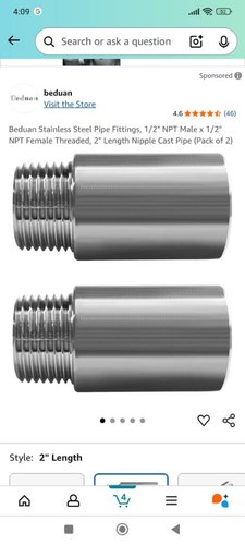

Postby X_Factor » June 19th, 2025, 4:10 pm
Anyone ever saw this selling locally?
1/2 inch npt threads
Posts: 29325
Postby pugboy » June 19th, 2025, 5:31 pm
yeah on aranguez main road
as you come off highway a little plumbing place on left heading north around mangra st or so
killercow
Posts: 1626
Postby killercow » June 19th, 2025, 7:09 pm
X_Factor wrote:Anyone ever saw this selling locally?
Eswil should have. Got fittings similar to those there when nobody else had.
