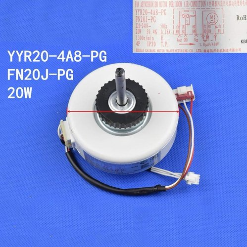

Postby nick639v2 » July 27th, 2023, 7:42 pm
Anyone know where I can get one of these motors? It’s from a 12k daikin
(Motor seems to be from here units too)
Tried a 27w motor but didn’t work
Peaks, maraj nor general in south have
Posts: 29380

Postby nervewrecker » July 28th, 2023, 4:09 pm
Lemme guess, stator toast?

Postby nick639v2 » July 31st, 2023, 3:33 pm
Well you help me out. I went and get the coil sensor,
It came me with ambient sensor on the same jack but I had to re-use my original room sensor to get the unit to cycle.
So some madness went on where both motor and coil sens crap Itself..
Ac give me more headache than ice machine and walk ins yes
