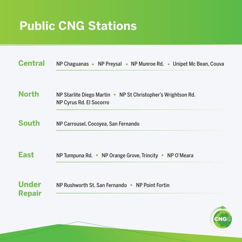

Posts: 21560
Re: Lets talk CNG
Postby K74T » June 1st, 2022, 2:44 pm
Time to refuel?
Check out the current listing of public CNG stations where you can refuel.

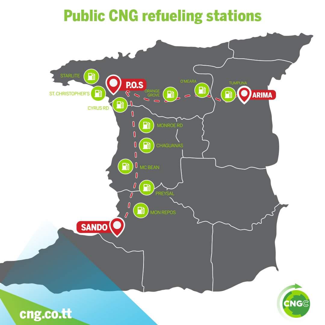

Posts: 21560
Re: Lets talk CNG
Postby K74T » February 28th, 2023, 8:05 pm
NGC CNG
As we work to improve the supply network across the country, here are the locations of the 11 public CNG filling stations.​
South - NP Carrousel, Cocoyea San Fernando ​
Central – Unipet Mc Bean, ​NP Chaguanas Main Rd,​ NP Munroe Road, ​NP Preysal​
East – NP Orange Grove, Trincity, ​NP O'Meara, ​NP Tumpuna Road Arima​
North – NP Cyrus Rd El Socorro​
West – NP St Christopher’s Wrightson Rd, NP Diego Martin, Starlite
