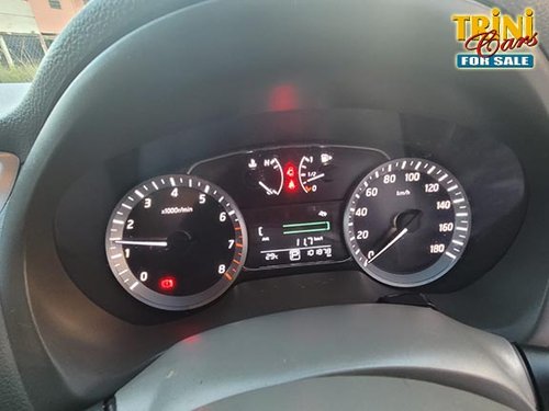

Dropping this for future reference.
Sylphy 1.8l - 11.7km/l
Posts: 28732
Re: Long Term Cost of Ownership Hybrid/Electric
Postby Duane 3NE 2NR » November 21st, 2022, 9:54 am
Bimmerhead wrote:Sylphy 1.8l - 11.7km/l
Highway?
Bimmerhead
Posts: 74
Joined: July 5th, 2013, 4:10 pm
Postby Bimmerhead » November 21st, 2022, 10:41 am
Highway?
Not sure honestly, just saw the vehicle for sale with the info available.
I'm trying to establish a little repository for local fuel economy, while highway and city driving contributes to the average and therefore the greater portion of either would skew the info in one direction or the other its still useful to me and i guess who ever else would want to make a quick reference check before a purchase or to advise others.
When i was searching for my car Google and Manufacturer figures wasnt an accurate depiction of our local driving conditions and habits.
