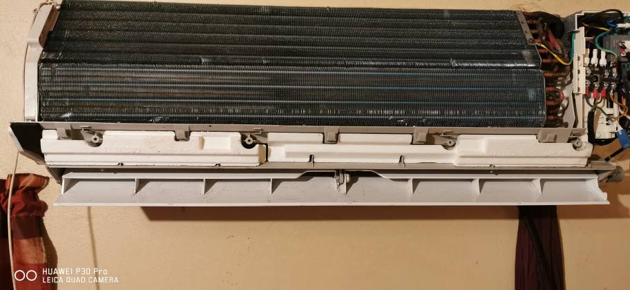

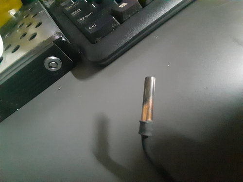

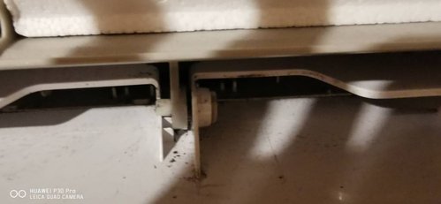

any AC men can tell me what is the issue with a lennox split ac giving an F2 error on the screen an nothing working. is it a sensor or just replace the entire board ?
Re: What the Best Split level AC Units...Carrier LG, Panasonic?
Postby rollingstock » June 21st, 2022, 9:18 pm
Usually just the sensor. But I ain't an AC man
Postby maj. tom » June 21st, 2022, 9:19 pm
https://lennoxglobal.com/en/PDF/Lennox_Mini%20split_11.5REE_Error_Codes(ENG).pdf
Malfunction Name
Indoor evaporator temperature sensor is open/shortcircuited
Display Method of Indoor Unit
(Error Code) F2
A/C Status
The unit will stop operation as it
reaches the temperature point.
During cooling and drying operation,
except IDU fan operates, other
loads stop operation; During heating
operation, the complete unit stops
operation.
Possible Causes(For specific maintenance method, please refer to the following procedure of troubleshooting)
1.The wiring terminal between indoor evaporator
temperature sensor and main board is loosened or poorly
contacted;
2.Theres short circuit due to the trip-over of the parts on
controller;
3.Indoor evaporator temperature sensor is damaged
(Please check it by referring to the resistance table for
temperature sensor)
4. Main board is broken
Postby nervewrecker » June 22nd, 2022, 2:00 am
daring dragoon wrote:any AC men can tell me what is the issue with a lennox split ac giving an F2 error on the screen an nothing working. is it a sensor or just replace the entire board ?
These things no longer fresh off the top of my head.
If its room temp sensor, unjack it and power up.
Pull plug, raise cover, press both hinges either to the left or right one at a time and pull forward gently. They should come out.
If yours has the display mounted to the cover remove the screws, they should come out with a size 1 phillip head. remove phillip head screw off cover to your right over the electrical panel and gently pull forward, it should come out.
If display mounted to the frame, no worries. remove screws still and remove, leave it attached top the cable. remove all screws from the frame in line with the condensate pan over the louver.
Pull louver open, it will reset itself on startup. There should be a plastic attachment at the center holding it in place with a pivot / guide on which it rotates. Shift it to the right to disengage the pivot and pull forward. Your swing motor should be on the right, its a female rectangular groove the rectangular rotor tip fits in. With the center forming a belly towards you hold the left half of the louver and pull it towards the center. it should come out the groove and then do the right side, it should come off the motor.
Has a rectangular tab covering one longer screw in the center at the bottom of the vent, remove.
There are 4 rectangular tabs at the top nearest the wall. Start from the left, get a very small flat head and fit it between the grey hook and white body. Nearest the back side of the rectangle hole. You want to either raise the white part a bit or press the grey part down. Push the body towards the wall while raising and pull it forward, it should come off. No do the rest.
Inspect to make sure everything free, some models have the thermostat in yellow passing out from under the electrical tab through a groove into the front under the filters. Fish it through and make sure your display etc can fish through it.
Might be wise to remove the filters. There are two plastic rods holding the face in place within two groves along the front where the condensate pan runs. Hold the entire white shell and yank it forward about a three inches. Saying "rahhh!" while doing so is optional.
You have access to your board now. Should have some size one phillip head screws and maybe a size two underneath somewhere. Remove and pay attention to the tabs on the cover, pop the cover and there in your board. Slide it forward, its in a groove. Look for your jack, un-jack.
If it was never molested before there should be a red piece of plastic on the jack preventing you from squeezing the tab. pry it out with a small screwdriver.
power up and see if you get the same error.
Your swing motor would have moved so it may be wise to fit back in your lover in it and get it to a position where it easy to put back in. if it reset the position will be set where it closed and you will need a birdbeak pliers to move it and risk damaging it.
Some lovers have a plastic thingamagij in the center that you can place a flat head under the flat part and pry off. it likes to pitch to beware.
Do the reverse for assembly.

Here are some hopefully helpful pics.
Yes my ac is scrapped out, yes I have a rag plugging the hole in the wall, no it has no screws and yes the display has been hanging there some time now.
Also, yes, it needs servicing....

Is this burnt or normal color? This was the sensor for the evap coil.
Postby nervewrecker » June 22nd, 2022, 9:30 pm
Normel, if yo have a good digital multi-meter check the resistance value of it, its a 5 kilo ohm sensor, place average low 30's high 20's ambient now so you should get anywhere around 3500 ohm.
Thing like 500 ohm and shiz mean scrap iron man for it.
That's just oxidation on the copper surface.
