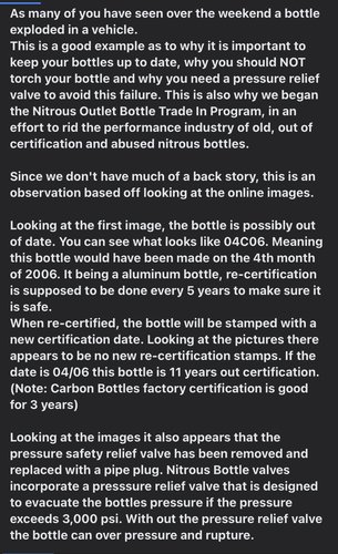

Article said the tank relief valve was replaced by a solid bung and well no relief was had. Stock relief valve was rated at 3000psi so that bottle saw more pressure than that.

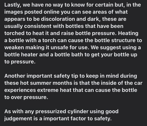

Screenshots explaining what might have happened

Doesn't look like it was torched, but there's no burst disc, so that's issue number one.
What probably happened?
I suspect the tank had some weak spots on the inside (micro cracks that were either not found on inspection or developed after inspection, if it was even ever inspected), and that the tank was pressurized with more gas than it was rated for, and heat caused said gas to expand to the point where the tank simply couldn't hold it, so it failed violently at its weakest point.
IF you gonna over fill a pressure vessel, make damn sure it can hold what you putting in it, and that it has a proper burst disc in the event of temperature induced thermal expansion of the gas inside it. As a general rule, a tank can be safely overfilled by up to 2-5% of its pressure rating, to allow for pressure decrease when the gas inside the vessel cools after being heated from compression. But 5% is the maximum.

N2o and CO2 behave similar, it's easy for a filled tank to reach high pressures with high temps.
Seeing pt chart for n2o going from just over 200psi at 5 deg c to 1100 psi at 37 deg c. In car temps can reach above 50 deg c easy.
