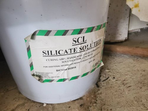

Phone Surgeon wrote:Scl also has chemicals that you can spray on or paint to seal the concrete after if need be.
I bought the other day when I find a new set of concrete was continuously dusting. Real cement dust.
Paid 490 I think for a 5 gallon bucket and used a agri sprayer to spray it on in 2 coats
Worked extremely well.
This is great. What kind of coverage you got with that five gallon bucket?
Posts: 20001
Re: Building a house in Trinidad
Postby Chimera » February 5th, 2022, 7:57 pm
2 coats of approx 40 x 30 feet.
2 coats sprayed on full with a manual pump sprayer. Tmr ill post up the chemical. I had buy two buckets and use 1

Phone Surgeon wrote:2 coats of approx 40 x 30 feet.
I would appreciate this info.
Interested in this too, what is the name?

If this is a SCL product, it could be Superseal B66.
BTW: you can use Poly-V as a sealer for dusting concrete. Dilute the Poly-V in water and scrub onto the floor.
Depending on size, traffic and condition of concrete, you can get about 24 months of protection from the Poly-V.
Posts: 20001
Postby Chimera » February 8th, 2022, 1:40 pm
The superseal b66 is a much more expensive product more suited for commercial applications. Warehouse and mechanic garages etc.
carluva
Posts: 1993
Postby carluva » February 8th, 2022, 4:22 pm
Ah yes. I know of that one. That is best suited for concrete that is heavily dusting.

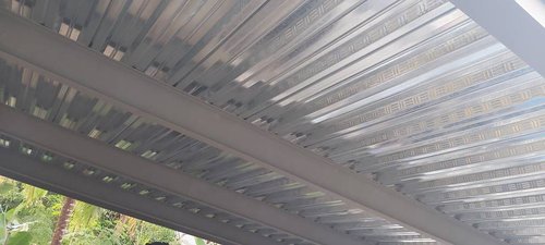

Good day,
So I'm preparing to cast my decking. My support beams are 8ft apart. Do I still need to prop this spacing when I'm doing the pour?
See picture for reference. Thanks
