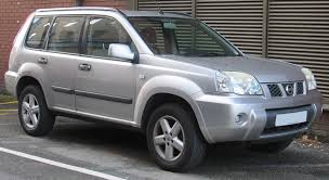

I was chosen as a winner for the free CNG NP competitions. I have an xTrail t30 and they indicate that I will have to pay 2000.00 extra. 900 for the install fee and 1100 for a 'bracket for the tank' when it is placed in the xTrail trunk area.
The competition , as they explained, is for the CNG tank free. Anyways, come time to install it...orginally I was excited about it but I have had this xtrail at least 7-8yrs now and it has served me well. now I have seen xTrails of this model with the CNG installed so I know people use it but I am just worried I am going to mess up a good thing. Car working, the CNG benefits may be useful yes, but the problems that may arise is a big concern to me.
So right now, I thinking of passing on that offer...

My advice, don't do it. As a previous winner it ruins the van. Ull be having to change suspension and for vans you only get 100km range if lucky. I regreted it and sold my van not long after.

Had 3 vehicles with cng, i have a traveling job so the savings were great.. Honest advise from my experiences
1 your suspension will not necessarily be affected because the excess weight is like transporting a person or goods which the vehicle is designed for
2 if the fuel savings aren't important for you, or you don't cover much distance daily then don't do it because the caveats of the conversion might not make sense.
3 the range you get with a car is approx 220 to 260km, but the xtrail is heavier and I'm guessing it's a 2.0 so your range will be approx 150 to 180km.
Basically you'll save about 60% of your fuel bill, check your annual fuel bill if the savings is significant then go for it, if it's not that much then it will not be worth it for you. Another consideration is the fuel prices going forward next year, remember if oil prices raises so to the prices at the pump.

Postby De Dragon » December 16th, 2020, 3:14 pm
christopherwilliams2 wrote:I was chosen as a winner for the free CNG NP competitions. I have an xTrail t30 and they indicate that I will have to pay 2000.00 extra. 900 for the install fee and 1100 for a 'bracket for the tank' when it is placed in the xTrail trunk area.
They have to stop this sheit now, and post a disclaimer or something. I know someone who "won" a CNG kit and was given all sorts of stupid, unnecessary runaround because it couldn't easily fit their vehicle (Subaru Legacy). No cash value, no kit to install yourself, but a long slow wait to get a "Subaru kit" :? :?
