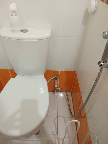

Why not install a shut off spray and hang it next to the toilet? You can TEE into the water line that fills the toilet tank and put a separate angle lock off valve. Much cheaper and just as effective as a bidet/bidet toilet.

I for one don't use it, but it is good when you cleaning the toilet and need to get rid of stubborn stains and rinse out the toilet brush.
My wife however uses it and uses it on the kids. And no problems there, except that the water could be cold, but I guess that'll be the case with an integrated bidet.
As long as water is available to wash the areas, it shouldn't matter whether it comes from up or down.

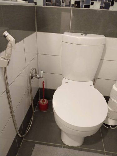

That's what I have. The second one is plumbed separately as it came with a valve and trim.
The first one is where it's TEEd from the fill line.

This somehow is not something that I would find inviting --especially when compared to the elegance in function of a bidet. But if it is necessary and it's the best thing that can be done under the circumstances, I won't argue.

Was looking at this 3 way diverter to use for the toilet spray hose
https://www.amazon.com/CACASO-Shower-Di ... 07W668GPB/

So one port of the valve is the water inlet, a second port is the outlet to the spray hose, but what will the third port be used for? Will you be using that to full the tank, in which case you'll divert water between the tank and the spray?
Sounds doable.
carluva wrote:That's what I have. The second one is plumbed separately as it came with a valve and trim.
The first one is where it's TEEd from the fill line.IMG_20200821_101203742.jpegIMG_20200821_101228097.jpeg
