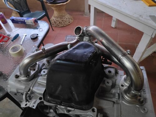

I do quite a bit of stainless steel Tig welding. With a large furick cup I flow about 20-22 cfh and then another 4-5 cfh for back purging. I eat through gas like crazy.
Probably some time down the road I can afford to have multiple 220cf owned tanks.

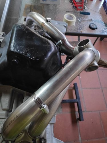

send some pics of your beads

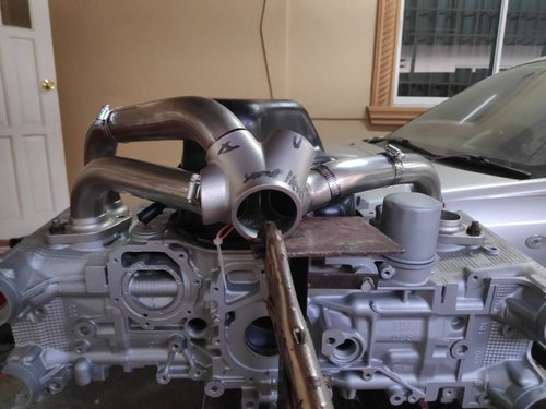

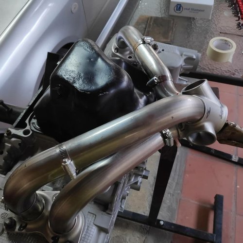

Postby Lance » May 6th, 2019, 6:46 pm
I'll take some shots of the next project. Current mocking it up now.
Some Subaru headers using 304 Stainless.

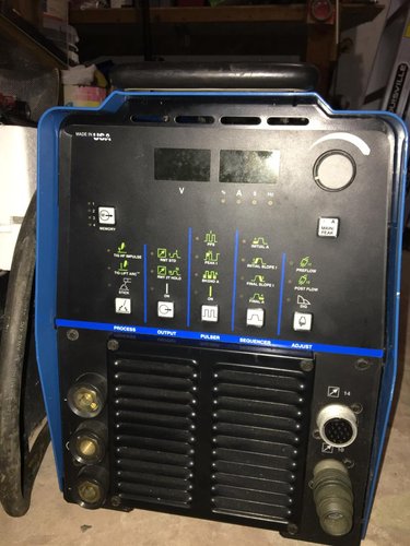

Got an older Miller Maxstar 300LX on a deal. Practically new
No TIG torch, cables, hoses, nada, just the unit
Previously I had a cheap fluxcore, so never had to deal with buying gas etc
So looking for advice on what, where, and how much, including argon

You need Ar for TIG welding. You will need a bottle (rent or buy) and a regulator. You can stick weld also.
Edoos, SSL, etc., will have a regulator, cables and TIG torch. I would guess about $200 for an Ar regulator but not sure on the cables because of quality, amperage and length.
If you plan on SMAW, you could do most of your welding with a stick until you are sure that the machine works well. You will use the same ground cable and clamp for TIG.

You might want to bring down your own bottle because igl only rents the huge bottles which are a pain to carry and you pay a monthly rental which will likely equate to the cost of buying your own.
