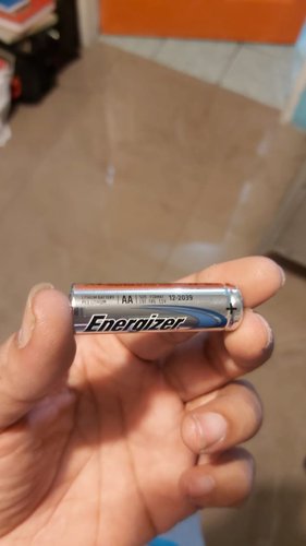

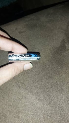

Anyone know where I can get rechargeable batteries like this locally
Postby adnj » July 9th, 2020, 8:44 pm
You can buy 1.2V AA NiMH batteries at Pricesmart, Peak Home Store and others but you probably know that already.
What you have is a 1.5V AA Lithium battery. They are not rechargeable. Lithium primaries are very long life. I have never seen any locally.

Postby pugboy » July 9th, 2020, 8:49 pm
The pricesmart Duracell rechargeable are very good, they are similar to the eneloop nimh and don’t self drain like older nimh
adnj wrote:You can buy AA NiMH batteries at Pricesmart and Peak Home Store.

Postby Chimera » July 9th, 2020, 9:37 pm
You're correct. I assumed they were somehow rechargeable as I've had them in a camera about 2 years outdoors. Thought it was being recharged with sunlight.
Can I safely use a 1.2 v instead if the 1.5
Postby adnj » July 10th, 2020, 3:44 am
Phone Surgeon wrote:You're correct. I assumed they were somehow rechargeable as I've had them in a camera about 2 years outdoors. Thought it was being recharged with sunlight.
Most electronics will tolerate the voltage sag from NiMH chemistry but you can't be sure unless you check the manual or try them out. The lower voltage likely won't damage your camera -- it may just not work with them.
Lithium primaries are of the same chemistry as some watch batteries so you get the same benefits: steady voltage, very long storage life and no leakage. But they cost about 10x what a Duracell alkaline costs so they aren't very common.

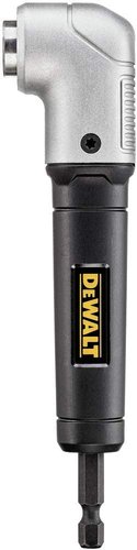

Any one knows if or where I could get one of these locally?

amd-dude wrote:Any one knows if or where I could get one of these locally?
Postby adnj » July 13th, 2020, 8:45 pm
TWLPARTS wrote:Lauglin
It's called a right angle driver attachment. Peakes, Bhagwansingh, Protools, SSL, etc.
