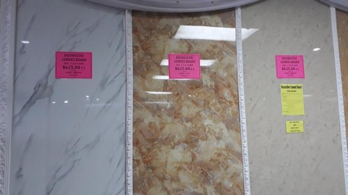

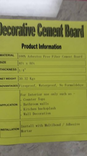

Guys I need some advice. I would like to use the decorative cement board for kitchen counter tops. It is only 1/4" thick though and I think the thin edge will look weird. What can I use or do to make it look like the thickness of a regular stone slab?

Postby adnj » June 17th, 2020, 9:48 pm
You can create something similar to a 1/4 bevel edge.
A wooden support strip is attached the underside of your counter underlament and flush to the outside edge.
A strip of countertop material is added to the face of the support flush to the top of or slightly above the underlament.
You will be left with a small gap at the joint of the counter top and the edge. Fill this joint in with a dark, pigmented epoxy of a complementary color. Sand and polish the bevel flat once the epoxy fully cures.
Works for most solid surface countertop materials if you want to avoid milling the edges.

Postby screwbash » June 18th, 2020, 4:25 am
so this decorative cement board cud take jammin? like a hot pot or a knife fall? who selling this product ?
NR8
Posts: 1872
Re: Building a house in Trinidad
Postby NR8 » June 18th, 2020, 8:30 am
So they say. Pionare Enterprises selling it.
