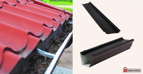

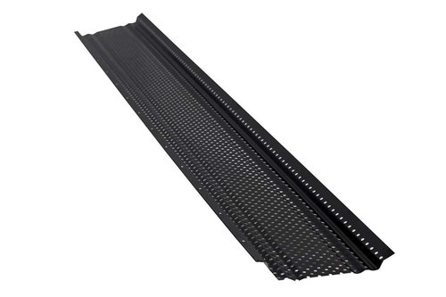

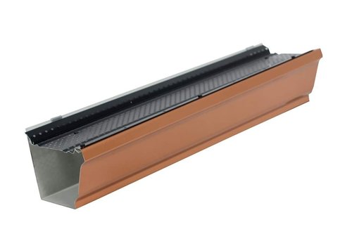

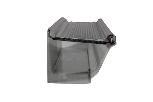

fokhan_96
Posts: 1820
Re: Building a house in Trinidad
Postby fokhan_96 » June 7th, 2020, 12:54 pm
Clogged or dirty gutters? Then you need the Damus Building Solutions Gutter Guard. Our high quality, 100% aluminium gutter guard helps you to keep your gutter system free of debris such as leaves, twigs, stems and other large debris. The DBS Gutter Guard is easily installed on any DBS Gutter K-Style 6" system and could also be retrofitted into existing DBS K-style gutter systems. The DBS Gutter Guard is essential for today's homes as it prolongs the life of your gutter, prevents leaks, saves time and money by reducing maintenance costs. Visit any location today for more info or purchase online at mydamus.com (Click on Gutter and search for Gutter Guard in the item description).
Dimension: 1 length, 10ft x 6inches
Price: $99.95 + VAT per length
Call 866-7663 (ROOF) Toll Free for more info.

NR8
Posts: 1872
Postby NR8 » June 7th, 2020, 1:19 pm
fokhan_96 wrote:Clogged or dirty gutters? Then you need the Damus Building Solutions Gutter Guard. Our high quality, 100% aluminium gutter guard helps you to keep your gutter system free of debris such as leaves, twigs, stems and other large debris. The DBS Gutter Guard is easily installed on any DBS Gutter K-Style 6" system and could also be retrofitted into existing DBS K-style gutter systems. The DBS Gutter Guard is essential for today's homes as it prolongs the life of your gutter, prevents leaks, saves time and money by reducing maintenance costs. Visit any location today for more info or purchase online at mydamus.com (Click on Gutter and search for Gutter Guard in the item description).
Call 866-7663 (ROOF) Toll Free for more info.FB_IMG_1591548814162.jpegFB_IMG_1591548808090.jpegFB_IMG_1591548805188.jpegFB_IMG_1591548800783.jpeg
Thanks!
