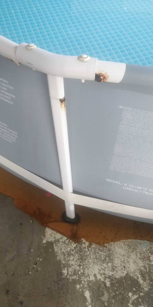

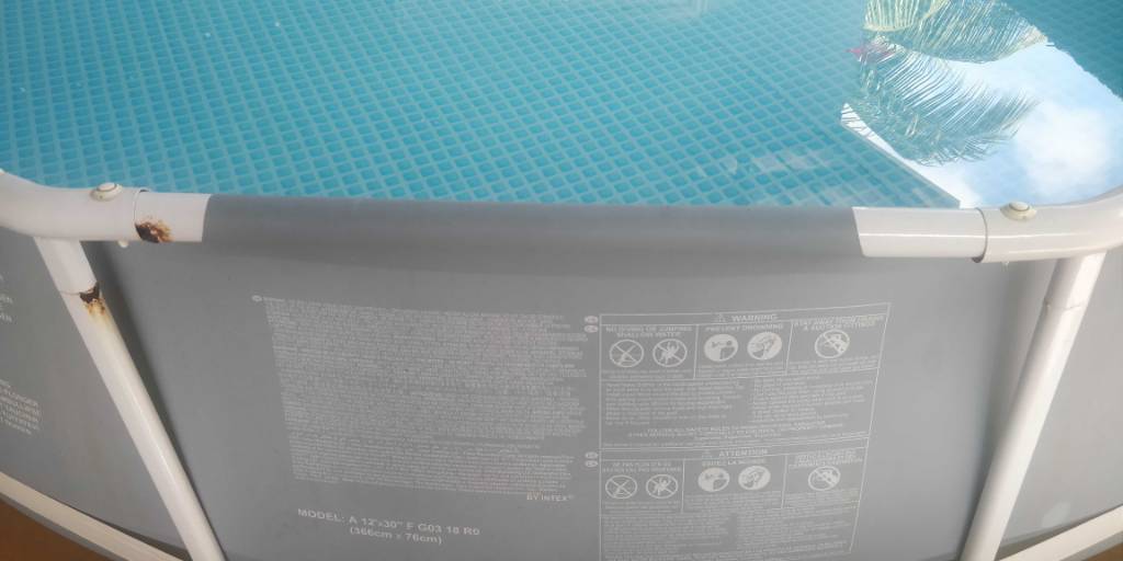

Anyone here does or knows anyone that can supply / repair the hollow piping used atop the Intex pool frames ? Mines have started rusting / rotting now and might not be able to hold up the water weight much longer ........replacement piping of the same type or even new pipe bent to suit .....thanks

Intex sells replacement parts on their website. You can ship it in from Miami.
Other than that, depending on the model, i'm sure it can be fabricated locally to required specs, but the two factors are cost and safety to hold that mass of water. I think 5 years for a plastic pool is good service and would buy a new one.

seems that the edge rubbing removes the paint and causes rusting

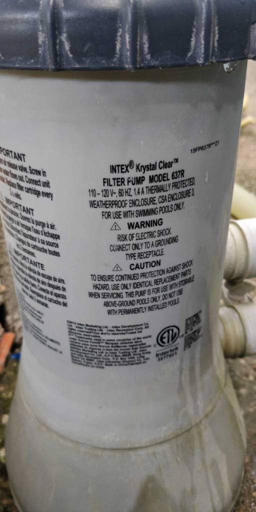

Premchand1976 what pump and filter system are you using?

next time spray some corrosionX there to help fight rust developing

Duane 3NE 2NR wrote:Premchand1976 what pump and filter system are you using?
This one

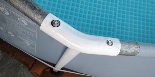

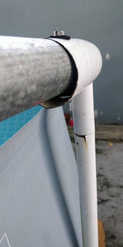

Update -
I checked the 1.5 inch schedule 40 pipe bit it was a bit too thick so I used 1.5 galvanised pipe and purlin screws . Was a bit smaller to fit but I think it's good
If I get 1-2 years life out of this material , I'm happy with that. Ultimate plan is the 10 x 20 x 48" rectangular ones.....hopefully for Xmas 2020

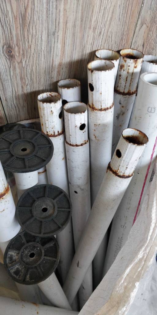

A fellow tuner gave me some lengths of the original pipes but for the regular frame one ....not the prism frame ....if anyone wants them......I will gladly give them away.....as he did.
See pics below.

good work, you will get good life out of that esp as the screws holding the pipe above so less rubbing and water settling to cause rust.
dont forget to get some corrosionX and spray where you see rust like on the vertical piece
make sure its not wet first.
