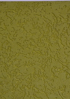

hi guys i need some info on a product called trowel on, want to know who is selling it locally and if theres any other product on the market that has the same finish, preferable south thanks
trowel on finish.jpg (47.1 KiB) Viewed 5339 times
trowel on 1.jpg (10.15 KiB) Viewed 5339 times
