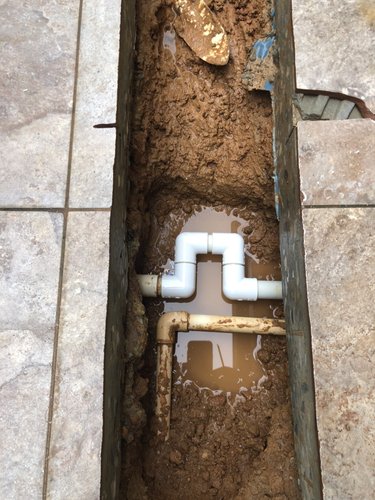

Guys I need some advice related to the pic.
That's a buried 4 inch pipe. It just takes rain water from guttering downspouts and surface water away from house to a main drain.
The top was cracked. The culprit was a root from a nearby neem tree that exerted some real strain on the pipe. I dug as you see there and cut out the cracked section on top. I really did that to clear the blockage of dirt that fell in.
Now I know I can use a 4 inch union and a coupling with a short section of pipe in between. I doubt I have enough wiggle room to set two couplings and a section of pipe.
Any ideas on how I can repair? I was thinking to get a small piece of 6 inch pipe and cut it across the section to get a "cap" to fit over that opening I made. Not sure if that'll work.
I looking for something easy and prefer not to dig deeper, unless I have to, which will be there case to install the union. The soil hard af and I don't want to bust my tail unnecessarily.
Any ideas to offer?
Thanks.
Re: Building a house in Trinidad
Postby rspann » April 8th, 2020, 2:13 pm
Patch it as you said but use the same diameter pipe . Sand it good before you stick and you could use a few tek point to secure it too . Use concrete to close back up don't use fill .
Postby adnj » April 8th, 2020, 2:26 pm
rspann wrote:Patch it as you said but use the same diameter pipe . Sand it good before you stick and you could use a few tek point to secure it too . Use concrete to close back up don't use fill .
That is the best method. I would use a patch with an extra few inches around the opening edges.
Seal the patch and secure it around the circumference with band clamps or perhaps galvanized wire. Use water to soften the soil under the pipes so that you can clear the path for the clamps.

Agreed. The galv wire could work since it won't be needed after the glue dries , so even if it rust out it won't make a difference . If you use tying wire and concrete , the concrete will make an oxide coating (passive layer ) on the wire that inhibits rusting.
Ever notice if you demolish concrete after 50 yrs the wire is still good but has a white coating ?
Postby jason_79 » April 8th, 2020, 2:47 pm
carluva wrote:Guys I need some advice related to the pic.
Any ideas to offer?
Thanks.
The attachment IMG_20200408_132646302_HDR.jpeg is no longer available
Since it’s just just rain water u could also do something like this. I did this for a 3/4 inch water main. U could also use 4/5 elbow instead
Postby rspann » April 8th, 2020, 2:50 pm
jason-79 ,good technique .

Postby carluva » April 8th, 2020, 3:04 pm
Thanks guys. I'll try a patch.
I did a repair using two 90 for a water line already.
I think the two 90 or two 45 will be a challenge as I'll have to dig some more plus it'll be a blocking point for and sediment and sludge that accumulates over time.
I'll try the patch and let you know how it works. I quite like the tips...

4 90's is a piece of money though . Shortcut is the best as no pressure is involved .
Postby adnj » April 8th, 2020, 3:54 pm
In general, a 4×90° circuit adds a good amount of flow friction.
What we do if you are patching a short section of PVC pipe:
- file the center lands from two couplings until they will slide over the pipe.
- place one coupling on either side of the patch.
- cut the pipe patch to the exact length between the pipe ends
- mark the pipe to show where the couplings should be when installed.

Postby pugboy » April 8th, 2020, 4:42 pm
how you sliding them fittings ?
with grease ?
i find bigger fittings does give real trouble to slide on
they bind a lot.
adnj wrote:In general, a 4×90° circuit adds a good amount of flow friction.
- add cement to all pipe ends and slide the couplings into place from either side.
Sometimes you can get away with only filing one coupling and install the other as you normally would.
Posts: 3935
Postby Gladiator » April 8th, 2020, 6:48 pm
Spann... That's actually a very bad technique. Use a union please. All them elbow will just restrict flow...
rspann wrote:jason-79 ,good technique .
