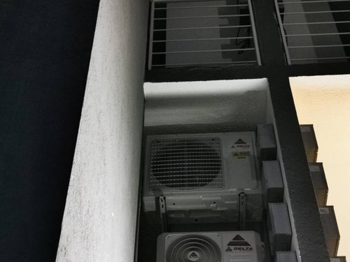

Customer wanna haggle with me and tell me the units can fit. I told them it can't. So they took me next door and show me it can fit.
I take pic, I ask if it have warranty, units get write off one time.
Hard luck dey Neil.
If you can't open the unit to do repairs or service how you expect to get warranty? Image

Whoever installed that like dey feel it was Tetris dey playing.

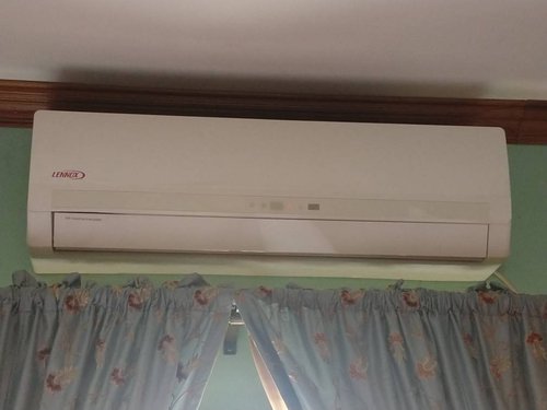

Need some advice.
I have a 24000 but Lennox unit as pictured. It's about 5 years old and for about 4 of those years it never worked as expected. Blowing too cold, too warm, icing up regularly, developed leaks on the coils, needed to be regassed.... Right now it's blowing cool and not cold regardless of the set temperature.
I'm thinking to replace it. On average, it runs from about 8pm to 8am and perhaps a couple of hours in the day. So figure 15 hours in average.
What will you recommend to replace with? The room size is about 14 ft X 21 ft with 9 feet ceiling.
I'd like to replace with a good unit that will last for more than 7 years. I am one who believes that the known brands, Trane, Daikin, Carrier, Rheem, Panasonic, etc. tend to be better but am willing to consider other brands if it fits the bill. Also, I'm looking at inverter units if it makes sense.
What is recommended?

Go find the person or company who did the installation ..
Lennox are the BEST units ..
Made in USA .. others from China and are cheap and ALL plastic .
Plastic ones are disposable ..
Disposable a Bic Razor ..

First off, red vevo, the lennox units we get here are made in china.
WRT lennox and daikin units having smaller compressors and lower rated capacity, the capacity is true and not exaggerated unlike other brands.
I had made an issue over lennox and daikin having 11200 btu compressors in the 12000 btu units among others but literature arrived from the engineers to represent their claims that it can do rated capacity.
FUN FACT: Lennox and Daikin have their own engineers that design their units. There are little tid bits here and there that gives them the edge over others.
I had discontinued the line after opening the systems and seeing inside but reintroducing them after ole talking with the manager Friday.
Secondly, I only getting back on my feet this week. Have to get my stitches out and clear up the back log with the guys.

I can get you Trane, by order only. price is like $9k for a 12000 btu, but....12 years warranty.
The inverter units are not units they can go to china and say they want x'y and z cheaped out on. They are made to operate between certain parameters and cannot be modified to do otherwise, so you get what you pay for.
I'd say pick your poison between lennox, daikin, gree, innovair and carrier inverter units.
Leaks develop on coils when the systems aren't vacuumed for the removal of all air from the lines. Water from water vapor reacts with the oil forming an acid that breaks down the coils from inside and the compressor insulation windings.
I vaccume all new systems to 500 microns an under or no valves arent opened.
The talk that the cheaper units fail faster or develop leaks is nonsense. I stayed clear of cheaper brands because they always have leaks.
The man that teach me this work have a GE unit home. A brand known for problems and failure with burn compressor and leaks on coils. Not one f**king problem and its been years,
Why? because he follow procedure and not shortcut like the men who hustling to make a change by flipping the cheapest they can find.
Third, beware of fake units on the market.
Doing a job for a friend, possibly a tuner and the neighbour come across to ask if we can service the units. I quote according to size of unit. He tell me is one size and I doubt him. What tipped me off is the tag in the wrong place, then the shell being the wrong shell. He told the tuner he paying plenty for his units and his units are sold at an affordable price.
An investigation has been launched into it so I cant say anymore right now. Its a popular place (not neil kool, neil units are legit stuff).

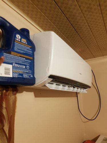

Giving this away for free right now. Can someone please come and take it.
Gree inverter. Image
