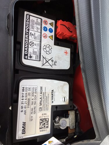

Thanks for the info. I bought one of the maintenance free battery from Price Smart just need to do the battery registration now. Current battery in car has VRLA/AGM on it.
