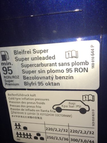

Anyone ever tried super in the new Jetta ?

Considering that it says minimum 95 I would love to hear from those who use straight super in theirs.
This document goes against my gas tank flap so who knows. Engine code CAVD.
http://docs.jayzone.eu/erWin/VW/Jetta%2 ... ndbook.pdf
