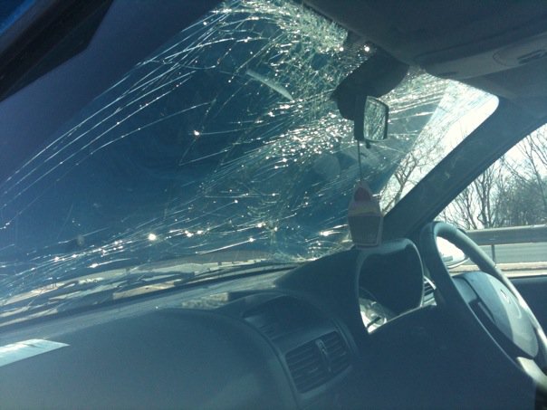

Postby Pointman-IA » June 22nd, 2013, 10:42 am
This is the result..

Pointman-IA wrote:Reminds me when the Renault Clios 2 had to be recalled in Europe with the bonnet issue.
Man say to drive a Japanese before you buy a VW yes..lol
