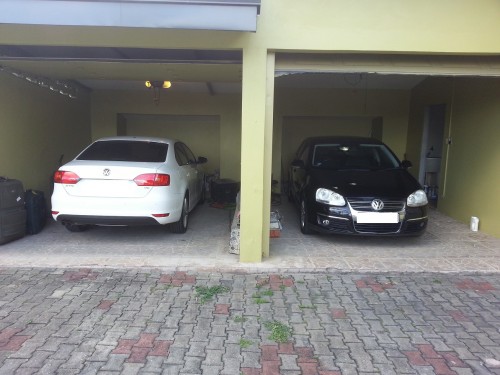

syncrod wrote:was just informed that BA will be handling the cost involved with the mechatronic unit replaceement. all i need to know now is the lifespan of this new and hopefully i should be driving vw next year
just got the Mk5 :) :)
on a side note the this is the forth mechatronic unit its one, and its working great so far (about 5 months and counting)
also got a 1 year warranty on the unit.
just waiting on the vcds cable
black is mine

Fourth yuh say?

syncrod
Posts: 256
Joined: September 27th, 2004, 8:38 pm
Re: Pros and Cons of new 1.4 tsi Jetta
Postby syncrod » May 7th, 2013, 10:17 pm
yea boy was real pressure with that thing
1 - failed (original)
2 - failed (short lived)
3 - didnt work
4 - current
first 2 were lady driven, so i guess it was luck of the draw

Now see why you getting rid of the Clio.....lol......
What plans you have for it?

nothing right now, car only has 17,000 mile on it.
maybe some 17" and coilovers eventually, lil power bump 200+
