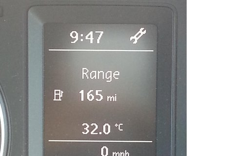

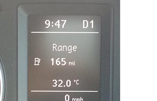

So guys..I have some news for you about my DSG in my MKVI Jetta...
It is failing..some signs to look out for are:
1. When put in a gear..the car does not move and the respective gear blinks on the dash.
2. A flashing wrench on the dash, alternating with the gear in place.
My car made 45,000 miles before this happened. Went today to see what they are saying, initially they said it was not the mechatronic..so they updated the car's software...went for a test drive and the flashing wrench came back.
This time it showed up with a Hydraulic pump error..mechatronic issue. They ordered it for me, so right now I am hoping that my car lasts until then.
Thank you for allowing me to place this note here for you guys.

Thanks for the info. Sorry to hear bout your issue though. When was your Jetta bought/made?

Fastredcar are you in heavy traffic during daily commute?

What kind of cost does the mechatronics carry
drchaos
Posts: 4372
Re: Pros and Cons of new 1.4 tsi Jetta
Postby drchaos » March 11th, 2014, 3:41 pm
Also they covering under good will or you hadda pay?
