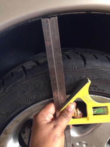

Only took a few pics. Started at 8:00am Sunday morning and finished at 8:00pm

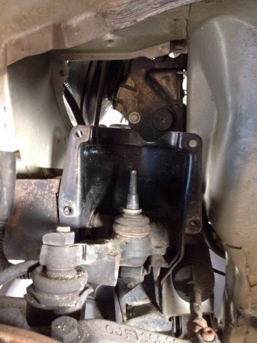

Started by removing the engine cover, ECU and all its attached plugs and connections, also had to remove the air filter box and piping, plus coolant bottle, all in order to access the top nut of each rear strut. Also helped in getting access to the nuts that keep the hydragas canisters in place.

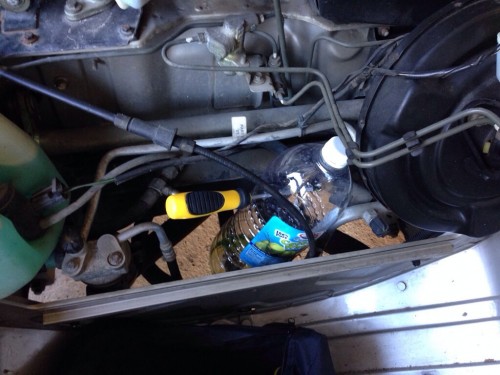

Front access to bleed the lines that pressurize the suspension. Line into bottle, then using the screwdriver to press the pin that releases the pressure
There's supposed to be 400psi of pressure. The bottle supposed to contain the spray. In my case, there was hardly any pressure, due to leaks in the system, causing the car to 'drop low'.

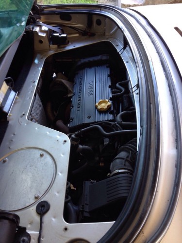

Engine access with top pulled back and cover removed

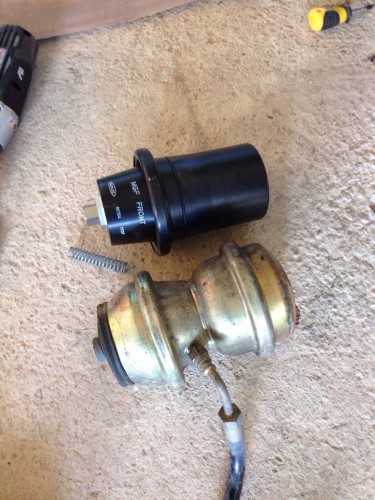

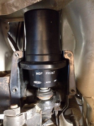

The gold thing is one of the old hydragas units. It's basically two spheres, one with liquid, one with nitrogen, separated by a rubber diapgragm. The suspension acts on a pin that pushes one against the other. The nitrogen compresses while the liquid is linked front to rear, so as a wheel moves up or down, the displaced liquid affects the wheel at the other end accordingly. Since these are no longer available, the solution now is four canisters (that black thing), each with a spring inside. The kit also comes with four replacement dampers too
Old one out
Nee one in

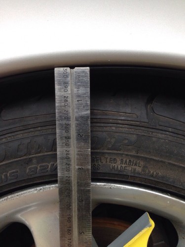

New clearance (before settling)
Car is now useable again. Before, the wheels were almost rubbing the arches, and with all the nitrogen seeping out over time, previous owners just kept pumping it up with more fluid until the system was rock solid, with only the tyres for cushioning. Surprised nothing ever cracked or broke
